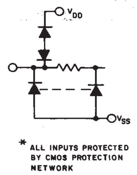

Hi all
Would you mind if we ask CD4504B?
How much is the maximum rating of output?
Is it -0.5V to VDD+0.5V?
Kind regards,
Hirotaka Matsumoto

    ->We would like to know the maximum voltage ratings at output pins like as 2, 4, 6, 10, 12, and 15 pins.
       For example, VDD is applied 16V, is the maximum rating of output pins -0.5V to 16V+0.5V?

  • Hello Matsumoto-san,
    If you are externally applying a voltage to the output pin, we recommend against driving the same line with two devices - this is called bus contention and can cause damaging currents to flow in both devices. This device does not have a high-impedance mode, and it does not have Ioff, so the output should not exceed VDD.
    If you need to know how much voltage the device will output, you can expect to get VDD at the output under DC conditions, and overshoot beyond VDD can be caused by light or inductive loads.

    The customer measured the minus transient value at output.
    The value was -0.8V, -100ns.
    So, it will be over absolute maximum ratings.
    Does the device damage?
    We assume that the internal circuit contains confidential content.
    For example, If Vout is -0.5V upto VCC+0.5V, does "0.5V" mean diode which is output to VCC?
    This is the diode protection on the inputs and outputs as shown in the datasheet.
    There is a diode on the output that goes to the negative side.
    You have to make sure that the current on the output doesn't exceed 50mA.
