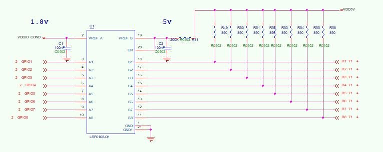

We are using LSF0108 as a level shifter for 1.8 to 5V and 3.3V to 5V. Because our  system A GPIO level is 1.8V and 3.3V, and system B GPIO level is 5V.
Now I have some questions need consult you
1. Do you need add pull up resistors on the low voltage side(in my system , 1.8 and 3.3V)?
2. How to config the GPIO pull-up or pull down internal resistors, does they have effect on the level shift?
3. Please see the attachment.
    In the schematic, vrefA=1.8V, vrefB=5V, and pull-up resistors on B side is 850ohm.
all A side IO are floating.
    What confused me is , Why the voltage is 2.1V  when I measure the A1--A8.
In other words, why the level is a little higher then the vrefA?
