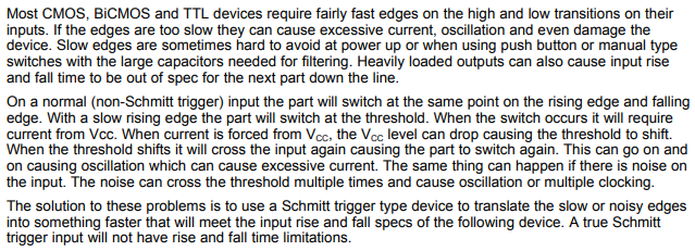

  • Hello Daniel,
    The SN74LVC1G17 is a Schmitt-trigger buffer, meaning that it has Schmitt-trigger inputs.
    The application report Understanding Schmitt Triggers includes a great deal of information about these devices, but the intro says it all:
    Bipolar devices do _not_ have the same restriction. They operate very differently... however you will find that CMOS is superior in almost every way. If you want to prevent excessive supply current by switching to a BJT based device, you will find that the static current of those devices is typically measured in mA, while CMOS device are measured in uA or even nA.
  • Thanks Emrys for the prompt and helpful response!
    I believe the important statement of the document you quoted is "A true Schmitt trigger input will not have rise and fall time limitations". It's a pitty that this important piece of information is missing from the document "Implications of Slow or Floating CMOS Inputs" www.ti.com/.../scba004d.pdf
    Anyway, great news.
    I conclude that this means that SN74LVC1G17 (Single Schmitt-Trigger Buffer) can handle slow "edged" input signals and convert them into signals with a much faster transition rate. Consequently, it generates a signal that is suitable as input signal for subsequent 74LVC* logic elements that do not include a Schmitt trigger input.
