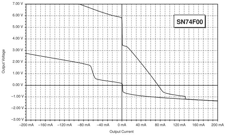

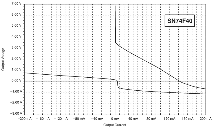

Dear Technical Support Team,
Do you have the graph of VOH-IOH Characterization?
My target devices are SN74F00 and SN74F40(Vcc = 5V).

Hello ttd,
We don't have the graph of the VOH-IOH Characterization.
However what you can do is extrapolate the VOH-IOH for the Vcc = 5V.
Do keep in mind that IOH should not exceed -1mA as listed in the datasheet.
Extrapolating the values in the datasheet should give a VOH min of about 2.95V and IOH of -1mA at Vcc = 5V.
