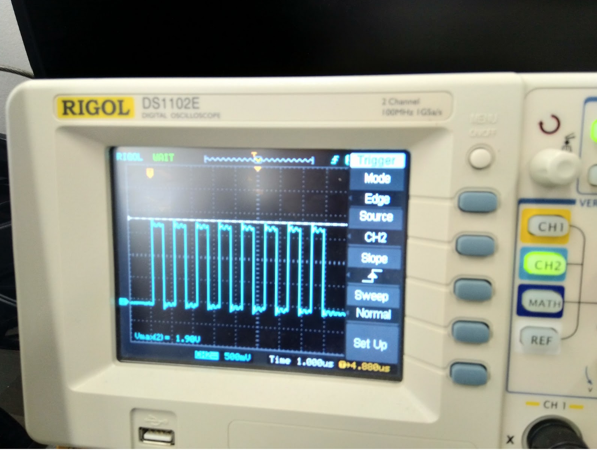

    For Case #2:
    Clock signal 1.8V before level shifter (pin A4)

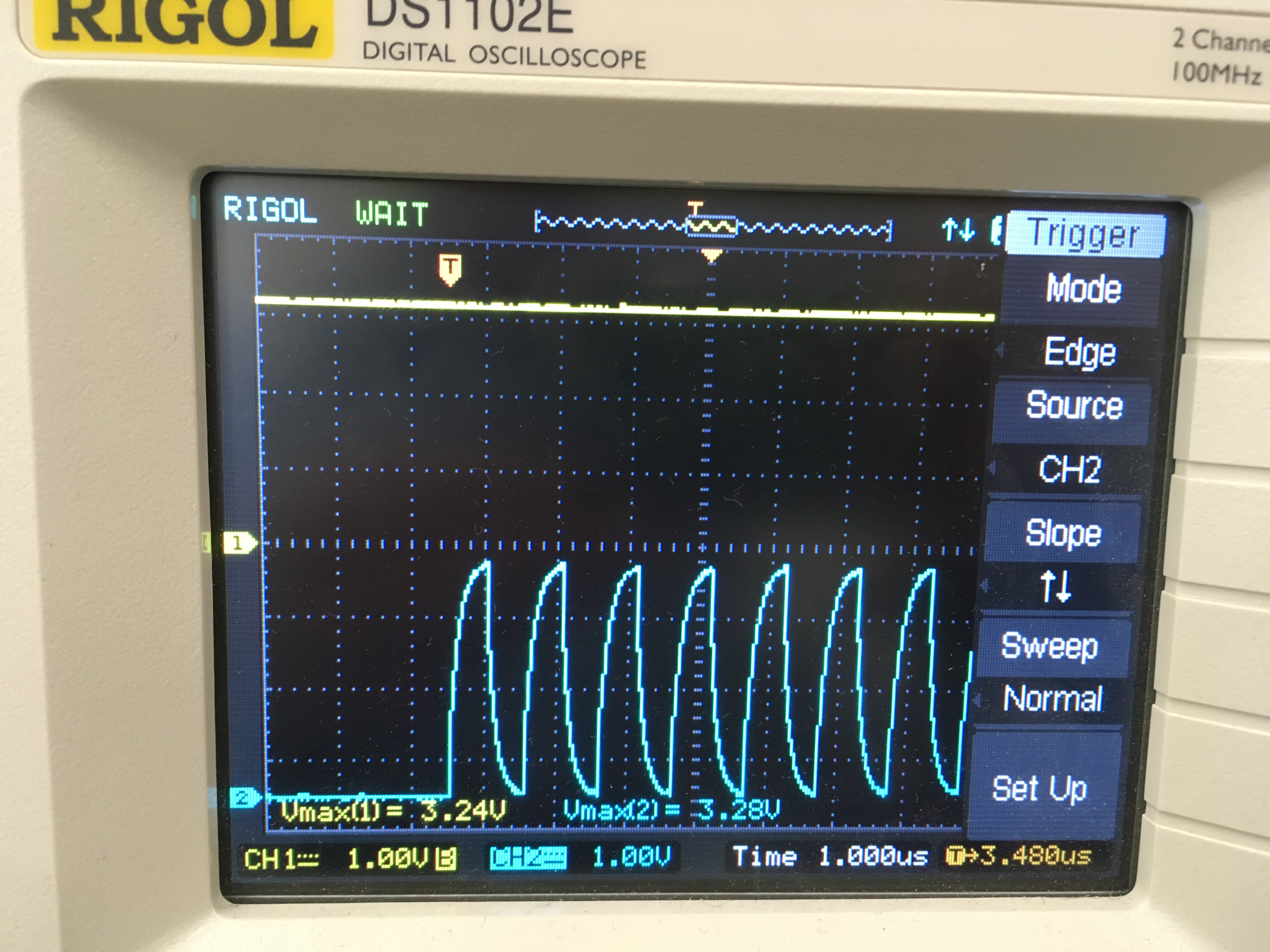

    Clock signal 3.3V after level shifter (pin B4) (presence of cables on the connector does not affect the shark fin shape):

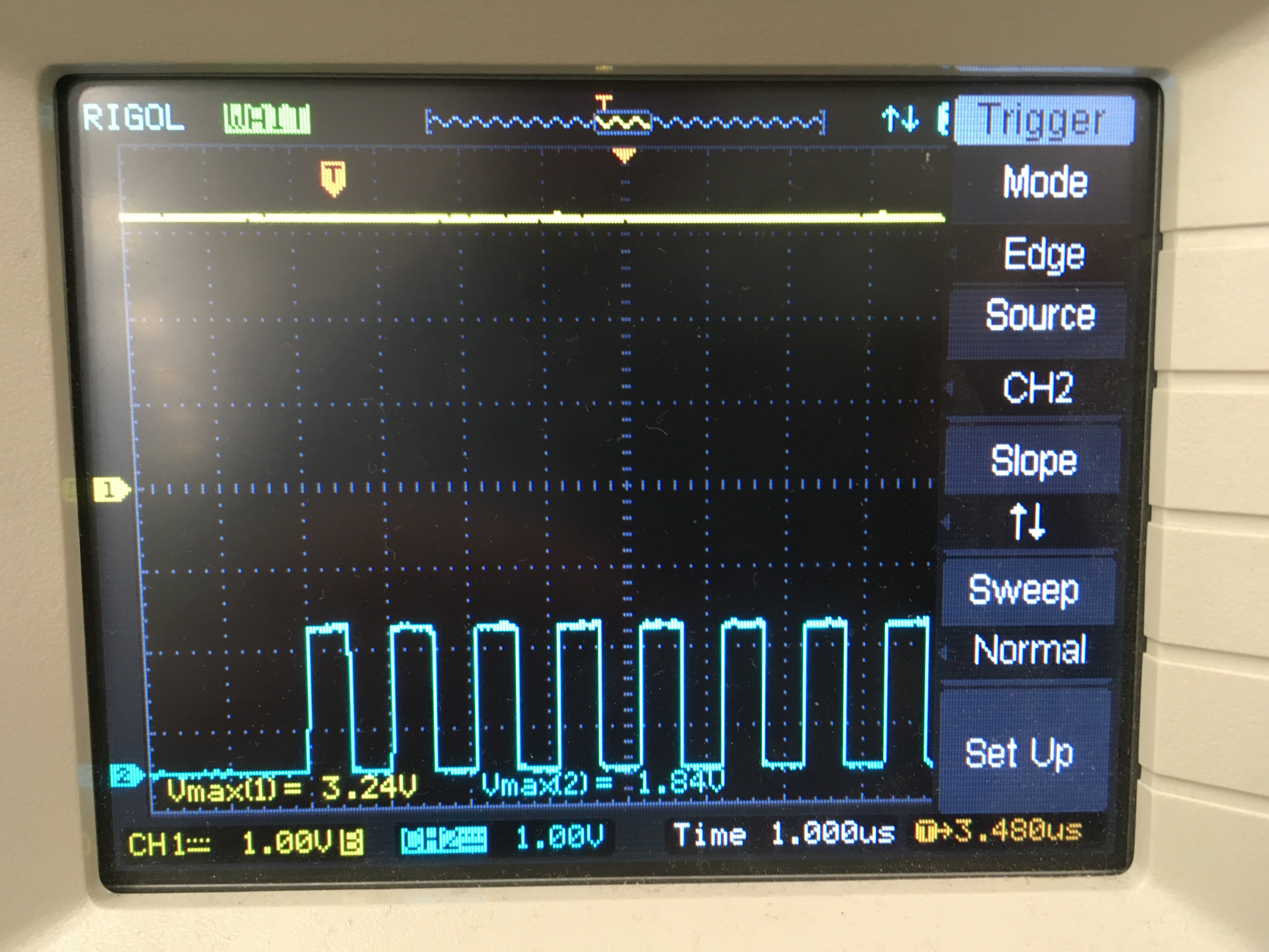

    Incoming data signal 3.3V side (pin A2) (note that the low level is not 0V as expected but 1.8V)
    To solve the latter, a 10 kΩ pull-down was added on the 3.3V board, this pulled down the logical low level to 0V and things work properly. This same fix does not work, however, when another cable is used.

    on the post, you have mentioned that the A2 signal is 3.3V, whereas the Vcca port supply is at 1.8V, why is that?

  • The shark fin shape also indicates to me that the output loading is large. do you know the scope probe capacitive loading. Are you using a passive or active probe?
    an SMB probe can have cap loading of at least 100pF + the board traces + input loading at the scope will be additional loading on the device.
    If its possible, please measure the output of the TXB device at the pin disconnecting the TI TAS5754 device and the series 100ohm resistors as well.

    [SR]>> on the post, you have mentioned that the A2 signal is 3.3V, whereas the Vcca port supply is at 1.8V, why is that?
    Sorry, mistake on my part, I meant B2. I checked this also on the PCB to be sure. So Vcca is 1.8V and A side is 1.8V, B side is 3.3V (in both cases).

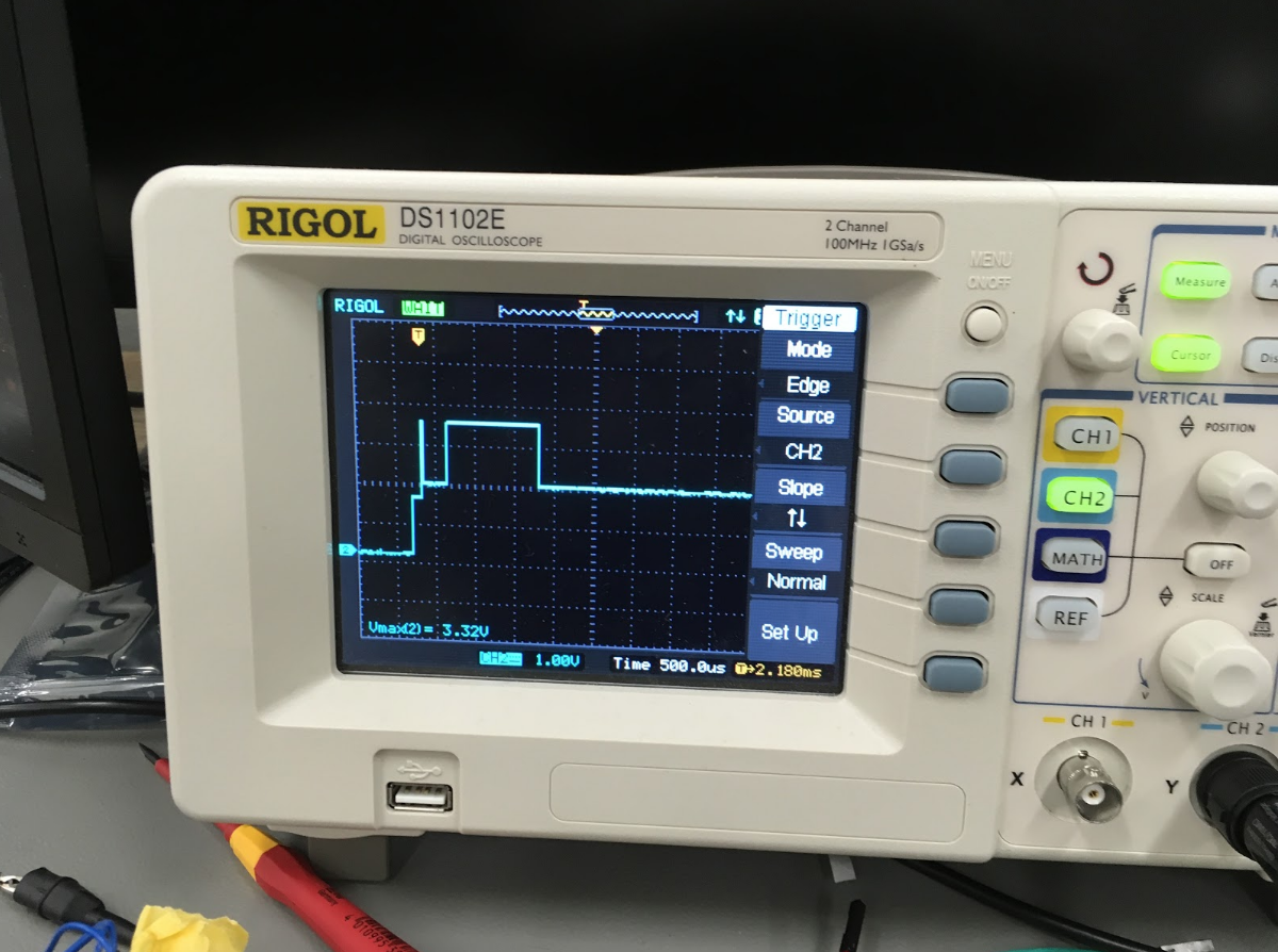

    What you see is this as input to the level shifter:
    And the output is this, without anything attached at the output, e.g. no pull-ups/pull-downs, capacitors or series resistors:
    The voltage rails on 1.8V and 3.3V show a straight line, no glitches at all.
    Drive strength of the Snapdragon is set to 12 mA.

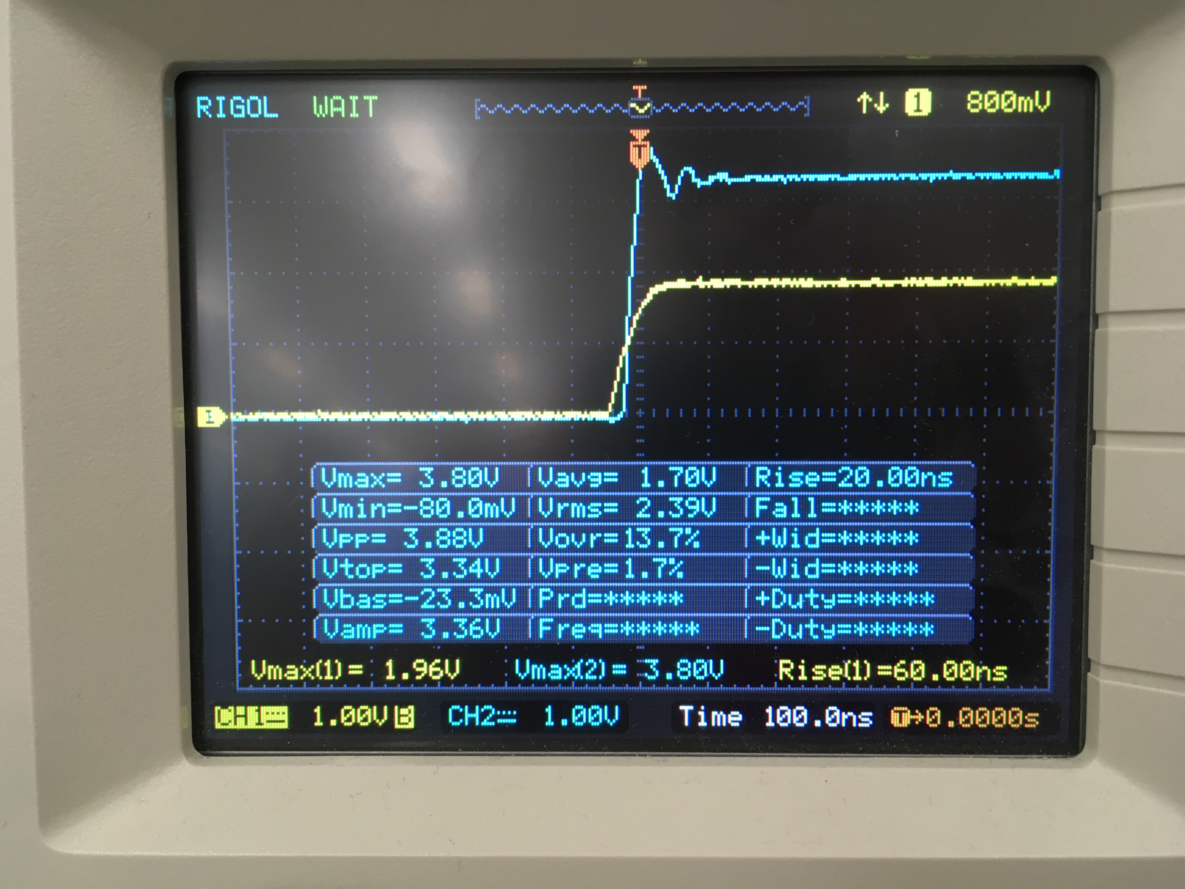

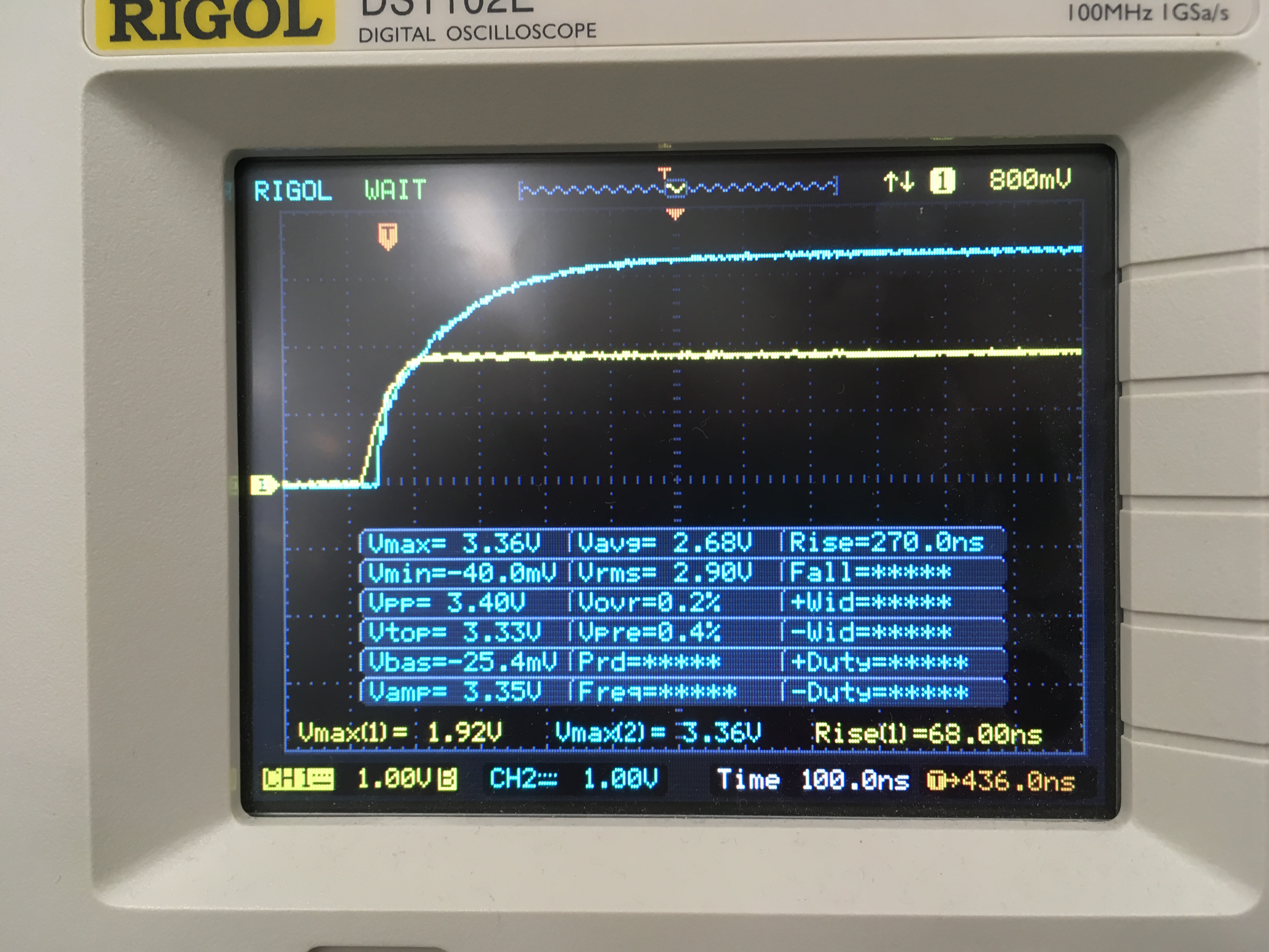

  • I created a measurement setup with the TXB0304 EVM and a home-made SN74AVC4T774 EVM. No pull-ups/pull-downs are present. Both devices are connected in the same way to the Qualcomm Snapdragon development kit. The 3.3V output is unloaded in both cases, just measuring with the oscilloscope.
    These are the results:
    Step function with TXB0304 (yellow = 1.8V input, blue = 3.3V output):
    Step function with SN74AVC4T774 (yellow = 1.8V input, blue = 3.3V output):
  • Hi Martjin,
    I believe the performance of the AVC4T774 is much better as compared to the TXB, as expected.
    Please let me know what you think and if AVC4T774 will be your device choice.

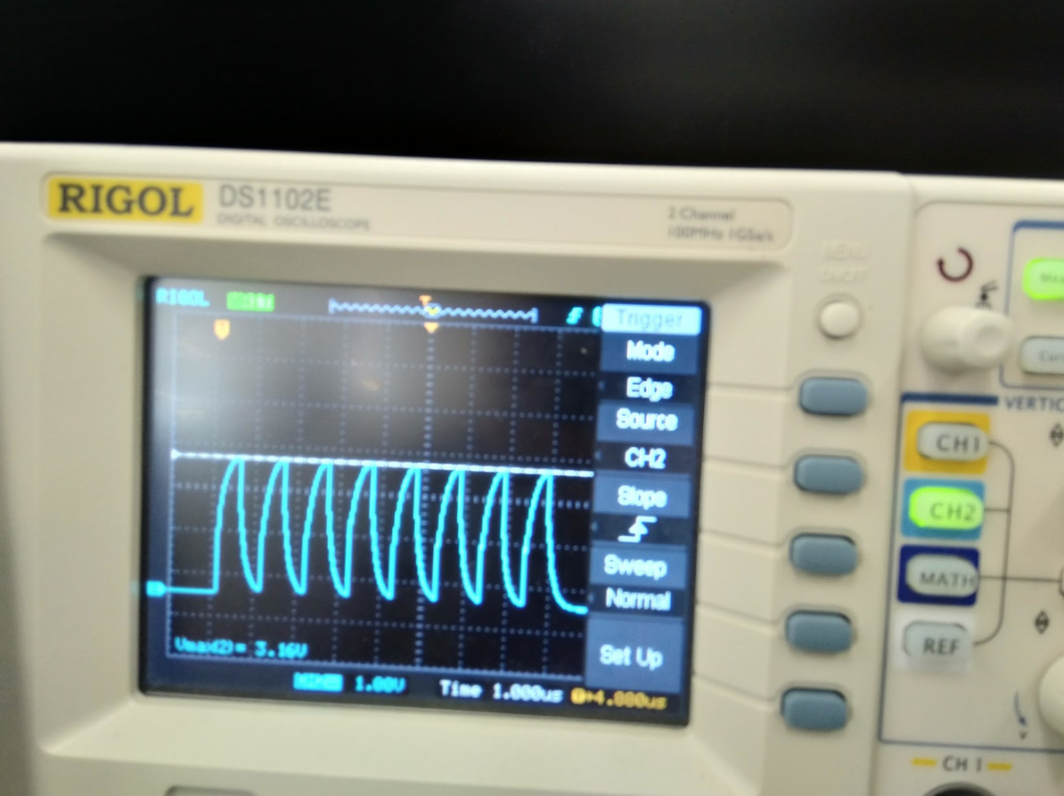

  • The board has been patched where the TXB0304 has been replaced by the SN74AVC4T774 using an adapter PCB.
    The clock signal, which is generated at 1.8V and has to be shifted to 3.3V, looks like this now (yellow line) (this used to be the sharkfin-shaped signal):
    The signal is crisp, and the ringing is correlated with the power supply, so we will have to add a capacitor near the level shifter power supply input near the IC (not done currently).
    Shifting the other way, from 3.3V to 1.8V level:
    So the level shifter also seems to work properly in this direction.
    Based on this I would say that the TXB0304 is not suitable for my application and that the answer is to use the SN74AVC4T774 instead. Thanks all for the support.
  • Martjin,
    The TXB devices are auto bidirectional devices without much drive strength and usually suited for high impedance loads.
    It seems that the loading on the output was beyond the TXB capability and I am glad that the actively driven AVC4T774 was able to resolve this.
