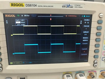

Our customer found that errors appeared in some channels of TXB0104 when every channel has input signal. I did some tests shown in below. And VCCA=OE=1.8V, VCCB=3.3V, input signal is f=1kHz, amp=1.8V square wave.

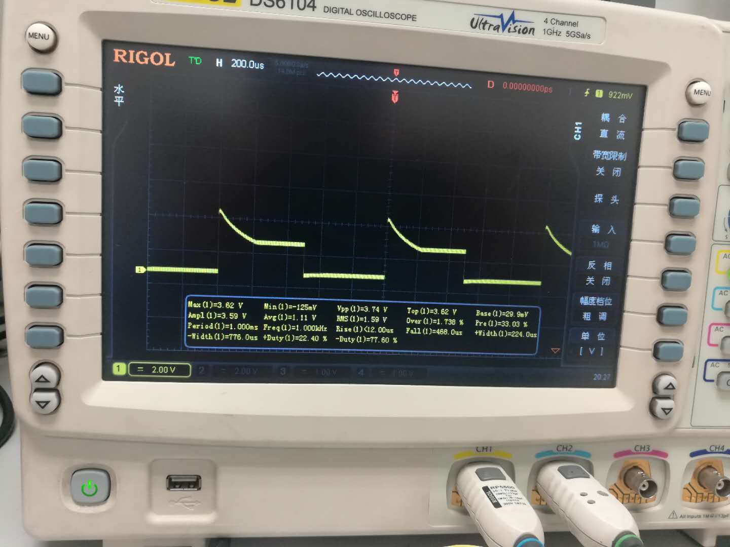

  1. A2B single channel test is operating correctly. For example, A1 is input, and B1 output waveform is correct when A2-A4 is grounded. Attachment1 is test result. The blue line is input, the yellow line is output.

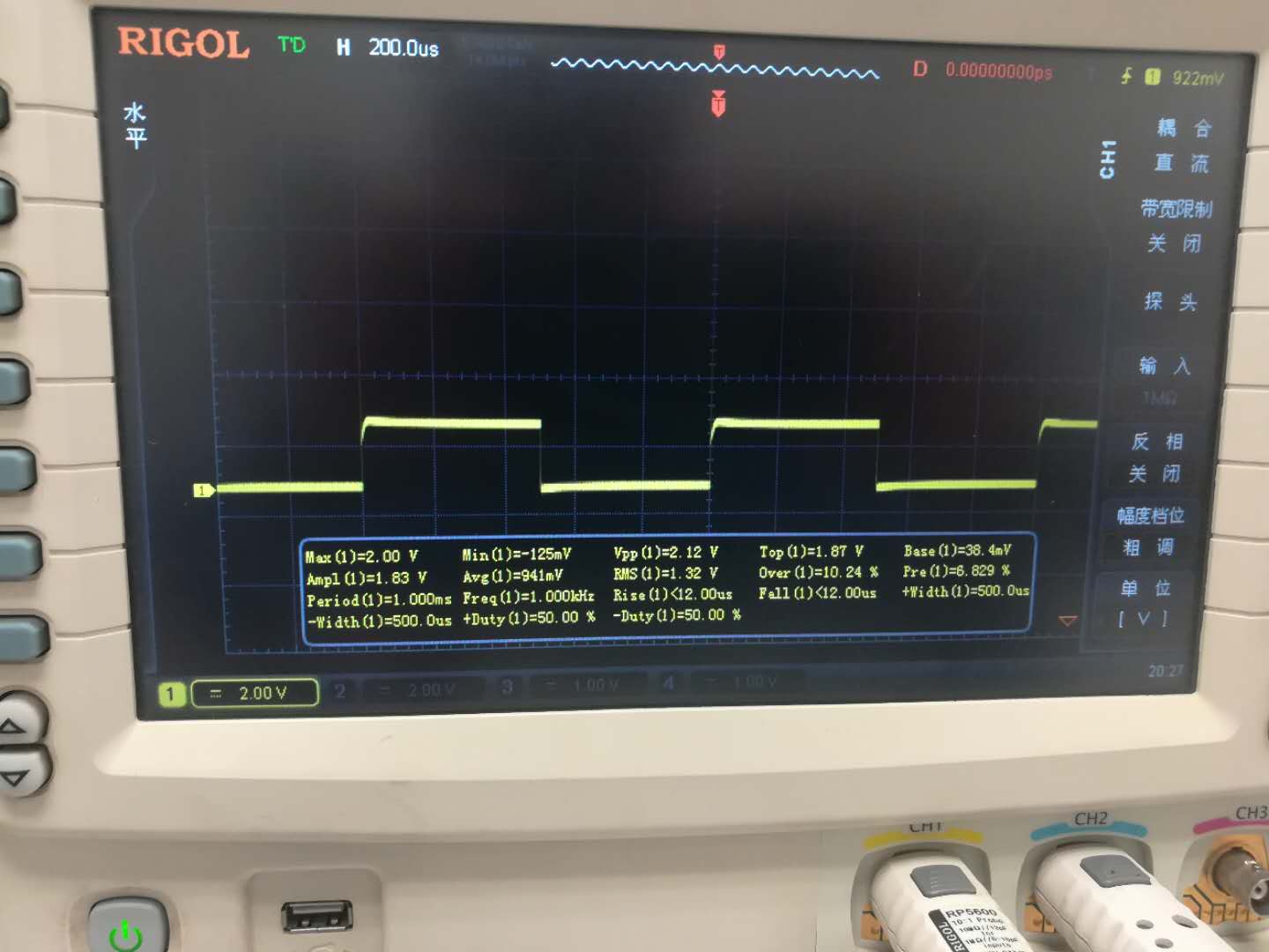

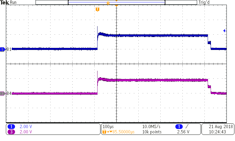

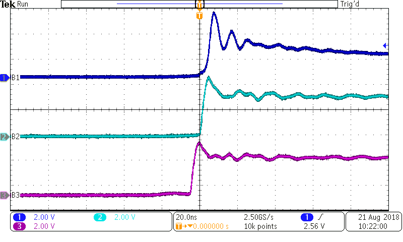

  2. A2B multi-channel test is abnormal. When IN=A1=A2=A3=A4, B1-B4 are all abnormal. Attachment2 is the test result of B1 and B2 while B3 waveform is close to B2, and B4 waveform is close to B1.
  3. I added 65KΩ pull-up resistor between B1-B4 and VCCB based on test2, and the output waveform became correct.

Attachment1:
Attachment2:

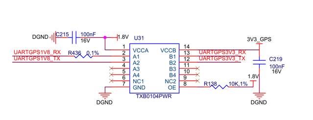

This is customer schematic circuit.
Thanks!

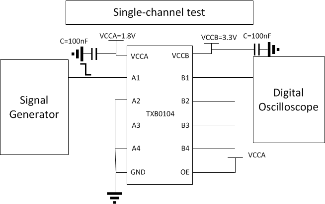

    what are the connections after the TXB ports?
    from the schematic, i see that there are unconnected IO ports 3 and 4, however, the second experiment connects the inputs to all of the ports? is it being driven from single source?

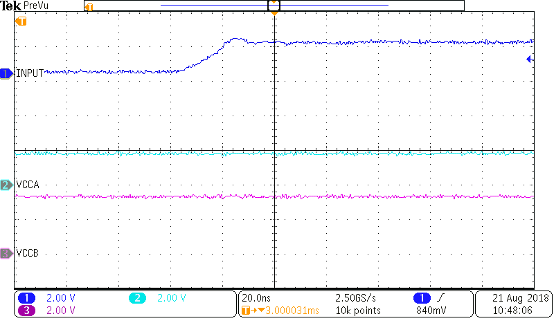

    A measurement of the Vcca and Vccb on the scope can also be helpful to see how is it acting when the abnormal behavior occurs.
  • Hi Shreyas,
    Thanks for your reply.

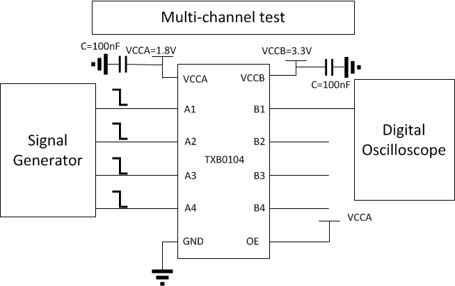

    The schematic is customer's application design.And below is my test diagram.The TXB input is connected to signal generator while output is connected to digital oscilloscope.And the 4 channel inputs were  driven by the same signal generator in multi-channel test.

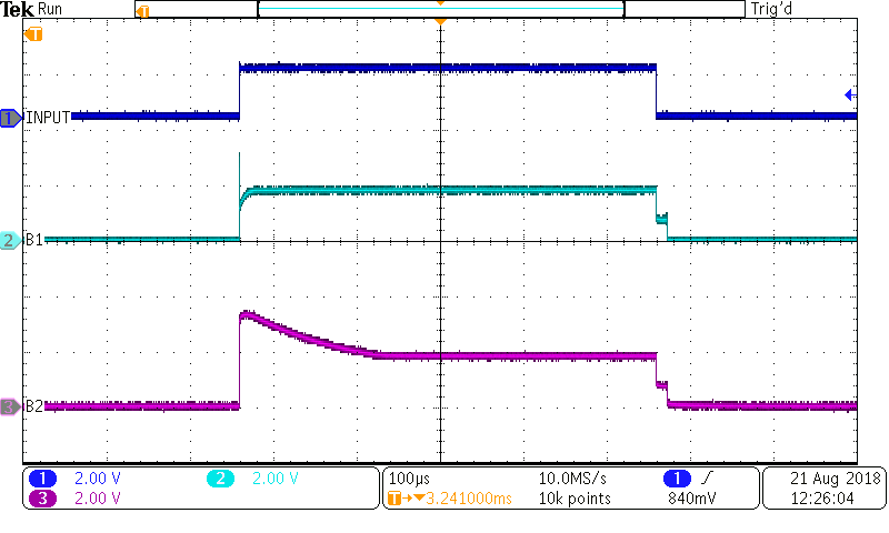

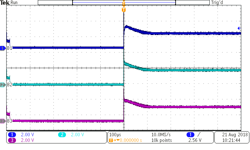

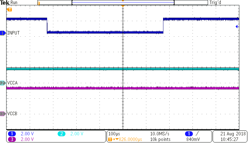

    And I measured VCCA, VCCB, INPUT(A1-A4), B1, B2, B3, B4 at the same time, the result is attached below.
    1) INPUT(blue)-VCCA(green)-VCCB(purple) window time=100us
    2) INPUT(blue)-VCCA(green)-VCCB(purple) window time=20ns
    3) B1(blue)-B2(green)-B3(purple) window time=100us
    4) B1(blue)-B2(green)-B3(purple) window time=20ns
    5) B1(blue)-B4(purple) window time=100us
    6) INPUT(blue)-B1(green)-B2(purple) window time=100us
    If you want to know more test details, please be free to contact me via email. I'll still post our discussion points here for others' reference.Of course, E2E is OK.
