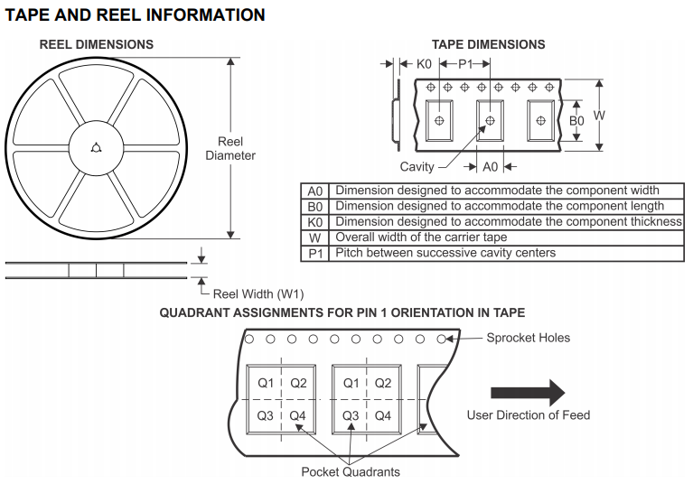

Kindly provide us the Tape Pitch, Tape Width and Pin-1 Orientation for below MPN:SN74ALVC244PWR
This information is not available on provided datasheet: www.ti.com/.../sn74alvc244.pdf
  • Hi Shruti,
    Thanks for bringing this to our attention. I see that it has info for other packages except that one. I am going to work on getting this info for you as soon as possible.
  • Hi Shruti,
    Device: SN74ALVC244PWR
    Package Type: TSSOP
    Package Drawing: PW
    Pins: 20
    SPQ: 2000
    Reel Diameter (mm): 330.0
    Reel Width W1 (mm): 16.4
    A0 (mm): 6.95
    B0 (mm): 7.0
    K0 (mm): 1.4
    P1 (mm): 8.0
    W (mm): 16.0
    Pin1 Quadrant: Q1
    Here is an image to correlate the above values with:
    We are working to get this data updated in the datasheet. It can be a fairly long process due to all the automated systems and people involved.
