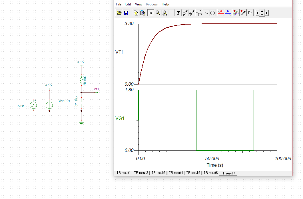

  • Hi Alpha,
    It is related to the SN74LVC07A since it is open-drain. There is no driver for the high output which is why you need a pull-up resistor to pull this signal high. See image below, I simulated it to help you understand.
    The red plot is the 15pF capacitor charging and the green plot is a 12MHz square wave. The output will be driven low before it reaches 3.3 V. 15pF for output is reasonable to assume since the o'scope probes add several pF alone.
