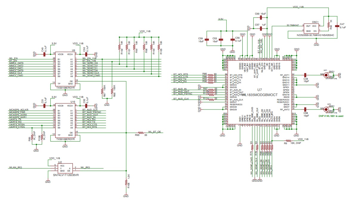

We are facing issue with the Level translation in TXS0108ERGYR IC. We are providing logic 1 (+3.3V) to one of the B channel pin(B1), we should get logic 1 (+1.8V) on corresponding A channel pin(A1) but unable to get it. Attached is the image showing the same of our our application.
Please let us know the whether we need to any other changes.
  • We are getting logic 0 (0V) on corresponding A channel pin(A1).

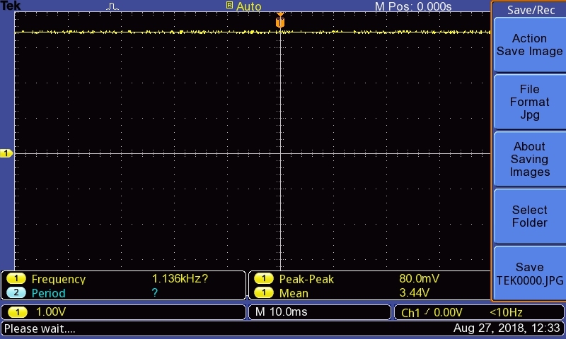

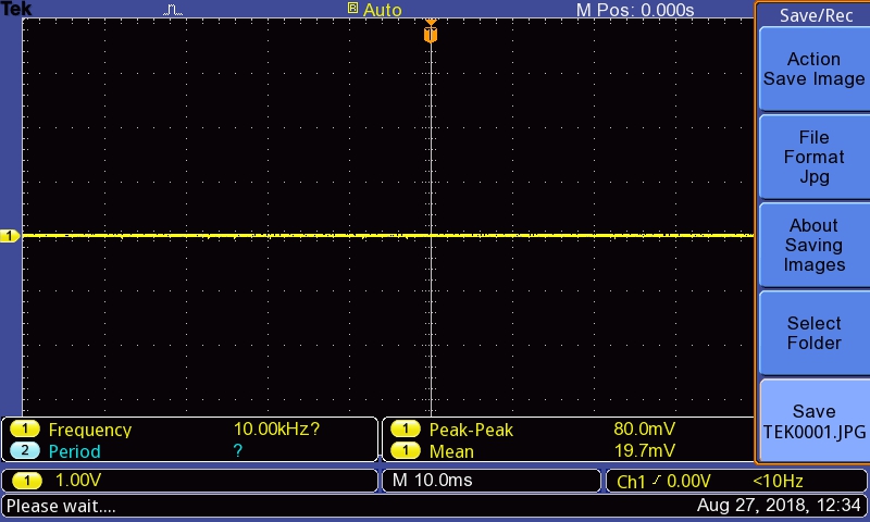

    Can you provide an oscilloscope shot of the input and output signals?
  • Hi Emrys Maier,
    Thank you for  the reply. Please find the attached images for the oscilloscope shots. Name of oscilloscope shot/image is as per the channel on which measured.

  • Hi Emrys Maier,
    We have also observed below cases:

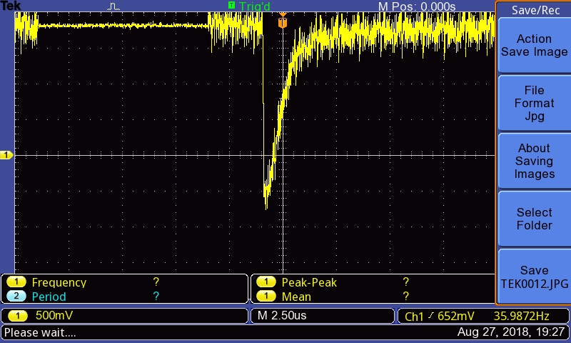

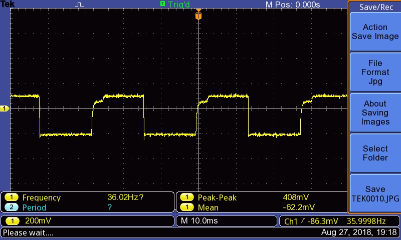

    1) When we provide a Clock signal on pin B7 from a function/signal generator, we observed below waveform on CRO. The corresponding  output on pin A7 is also shown below it. During this measurement the pull-up resistor R103 was mounted on MMC2_CLK signal on Pin A7.
    Signal on Level Translator Pin B7:
    Signal on Level Translator Pin A7:
    2) When we provide a Clock signal on pin B7 from a function/signal generator, we observed below waveform on CRO. The corresponding  output on pin A7 is also shown below it. During this measurement the pull-up resistor R103 was not mounted on MMC2_CLK signal on pin A7.

  • Hi Kamesh,
    1) Why is the input to the TXS0108 not DC offset? I see that the swing of the input signal is around zero. The input should be corrected.
    2) The TXS0108 device shown here have pullup and pulldown resistors externally. Please remove these. the TXS devices have internal pullup resistances which should be sufficient for operation.
    3) The TXS device OE is connected to gnd by default through the pulldown resistor but the OE is active high enable pin. What is the status of the WL_BT_OE pin?
    There are 2 TXS0108 devices in the schematic. Is the issue seen on both of them or only on U9 or U10?
        OK I will add some offset in the signal from Function Generator. But why DC offset is required to be added ? This will not allow to shift the square wave below the reference on output..right ?
        Actually we have followed the beaglebone black wireless design and also have the board with us. In this board, the level translator is perfectly working even with Pull-up and Pull-down resistors. Below is the link         for the same for your reference:
        We have enabled the OE by pulling it high but still we are not getting the results.
        The issue is seen on both of them.

  • Kamesh,
    The signal not having a DC offset is actually violating the abs max conditions of the device which states that the input port should not go below -0.5V.

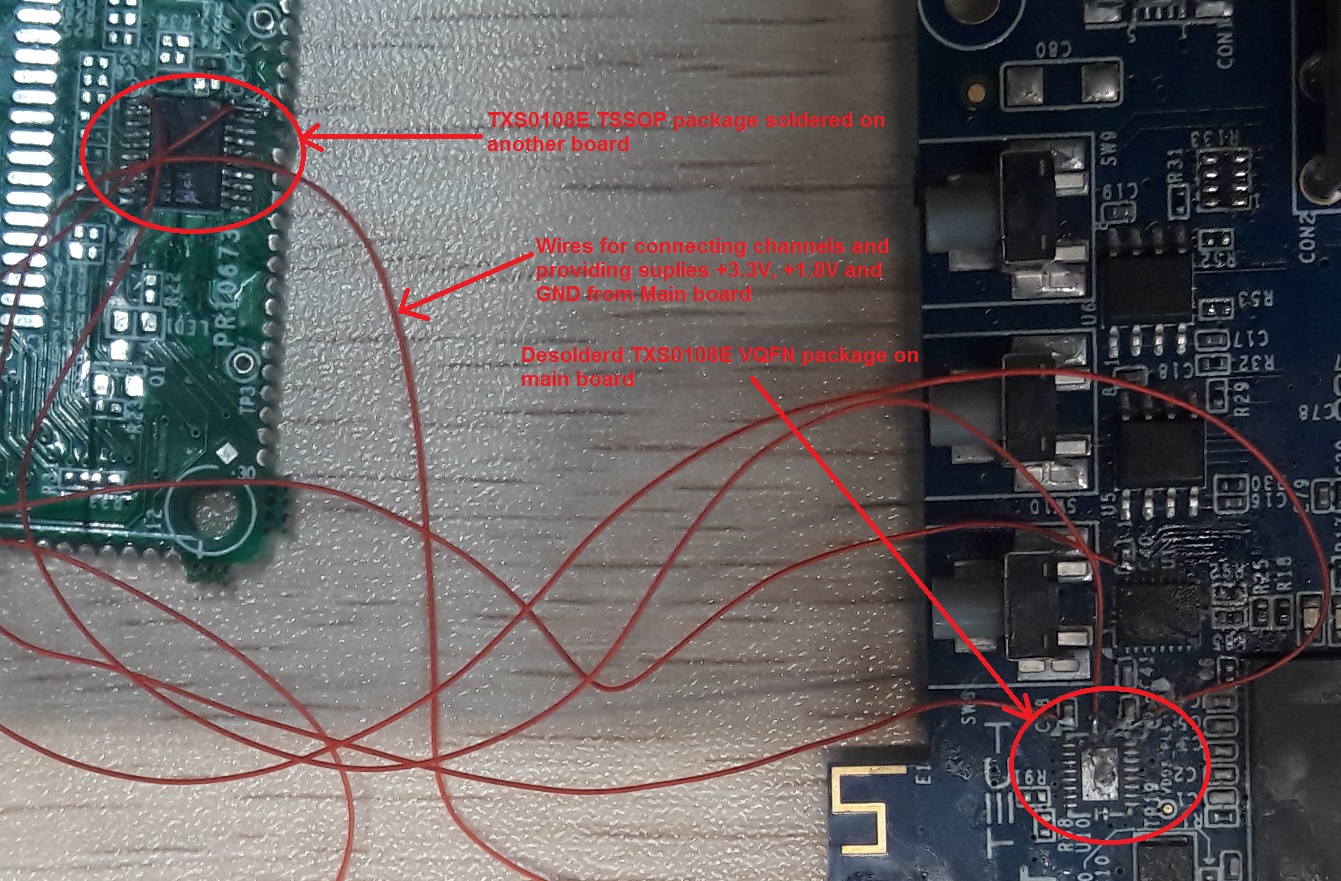

    We have performed one exercise as below:
    1) Currently we are using VQFN package of the TXS0108E on our Main board(Actual customized hardware that we have made for our application). We mounted TSSOP package of TXS0108E on another board
    2) On the Main Board, we unmounted/desoldered the IC U9(ref des as per the schematic)
    3) On the Main Board, we shorted channel B1(WL_EN) pcb pad with +3.3V supply, so that we get logic 1 on this pcb pad
    4) Took wires from channel B1(pcb pad) on the Main Board and soldered it on channel B1 of the TSSOP package on another board
    5) Took wires from channel A1(pcb pad) on the Main Board and soldered it on channel A1 of the TSSOP package on another board
    6) Also, we have given supplies +3.3V, +1.8V and GND connections from our main board
    We observed that the Level was translated on the TSSOP package. That is, with logic 1(+3.3V) on channel B1 we are getting logic 1 (+1.8V) on channel A1.
    Attached the image showing the above explanation.
    Kamesh

  • Hi Kamesh,
    The fact that the TXS0108 works on one board, but not on main board indicates that the device is functional, working as expected and doesn't have issues. It may also be an indication that the main board needs to be looked at for possible defects.
    Are both the system gnd and device gnd at the same level on the main board? is there anything on the main board which is loading the output such that it is not able to maintain the 1.8v level?
