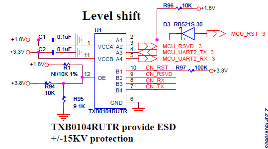

TXB0104: Used TXB0104 for one way level shift?
Part Number: TXB0104
Dear Sir:
                 We used TXB0104 for level shift as below picture and we would like used one way level shift of channel 1 for MCU reset function.When we tried to series diode to A1 pin then A1 pin can not active  high  ,so we also tried to add pull up resistance then the issue is solve. Would you kindly help to check below circuit is workable? Does it will have potential risks?thanks.
