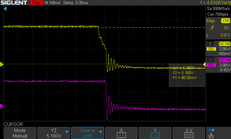

    I guess that having the SN74AHCT1G126 buffer on the lines could enable the translation from 3.3V to 5V without the need for TXB, but it wont work for 5 to 3.3V.
    Having the sn74LVC1g126 buffer after the TXB output on the daisy chain could cut down the cap loading and hence the translation using the TXB could work as well.

    Attached "Screenshot 1" shows the transition (high to low) oscillations on the Tx signal (both 5V and 3.3V) when 4 UART devices are attached to the bus.

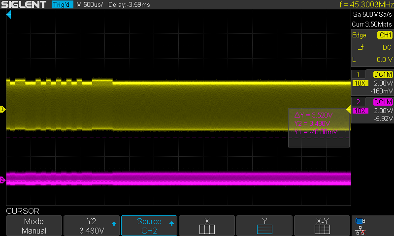

    Attached "Screenshot 2" shows the 5V and 3.3V Tx signal when 6 UART devices are attached to the bus.

  • Hi Brahim,
    As a drop in replacement with higher cap loading capability, i would suggest TXB0304 device. It has 1K internal series resistance which is smaller than the 4K internal resistance of the TXB0104 and hence has higher drive strength and load cap ratings.
    Other than that, as i had mentioned about using buffer like the SN74LVC1g126 at the output of the TXB to increase the drive strength will be advised.
