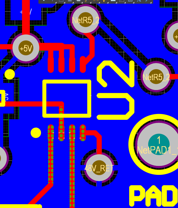

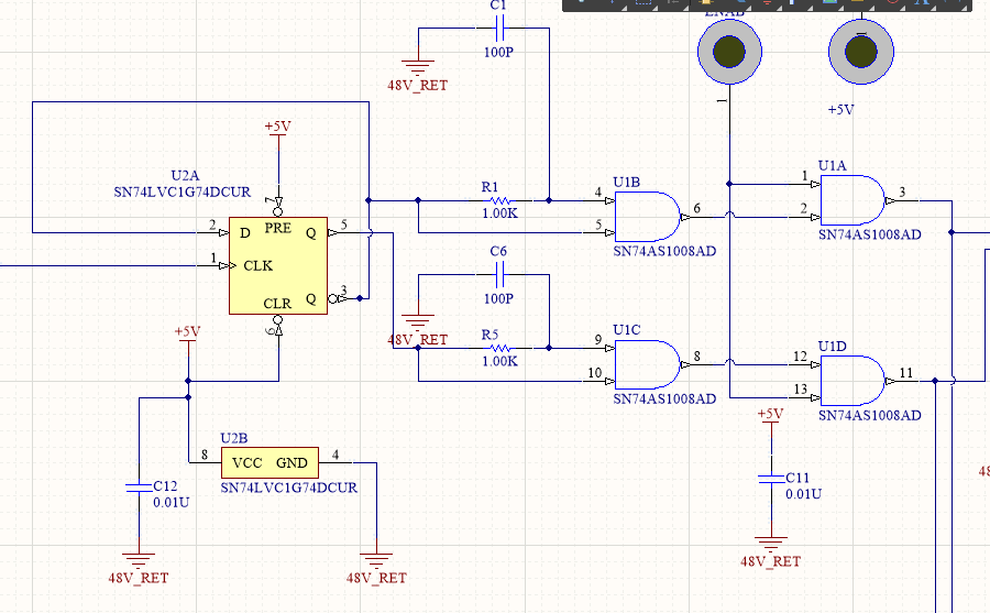

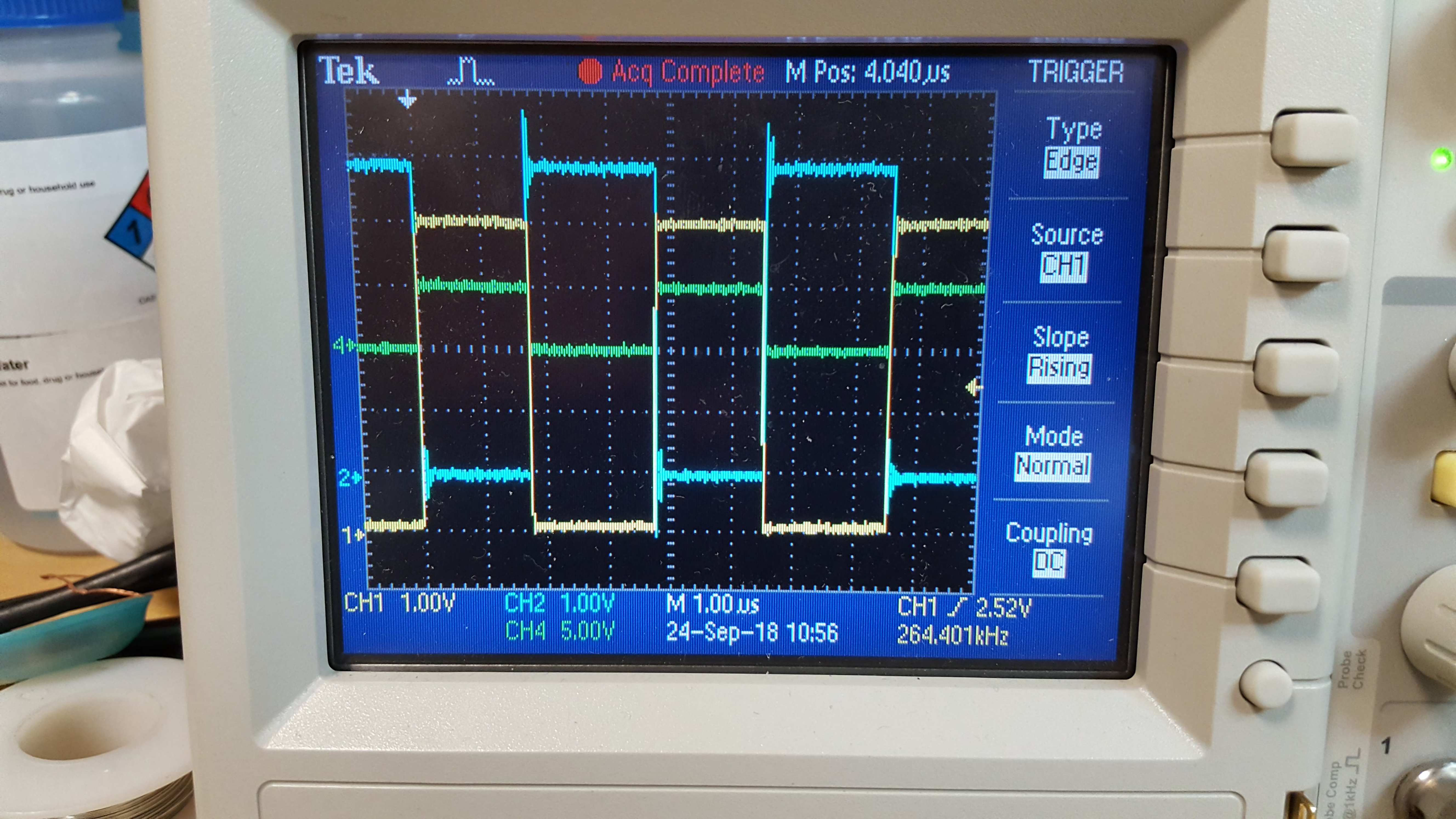

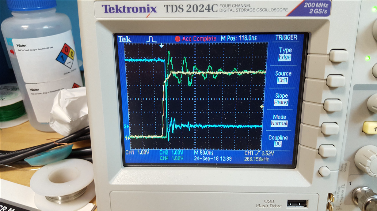

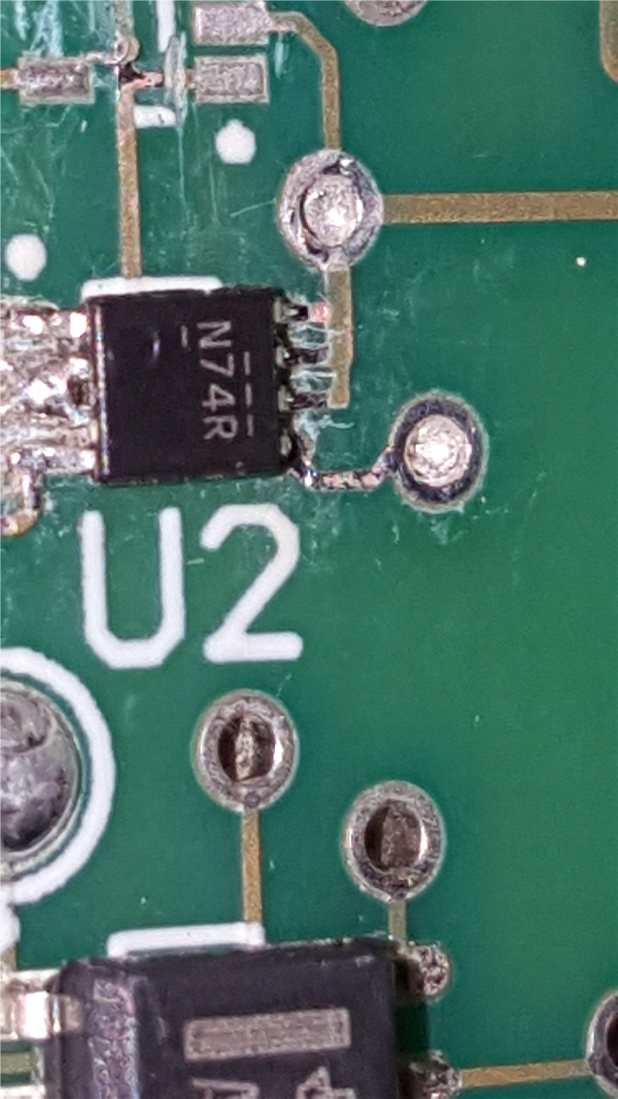

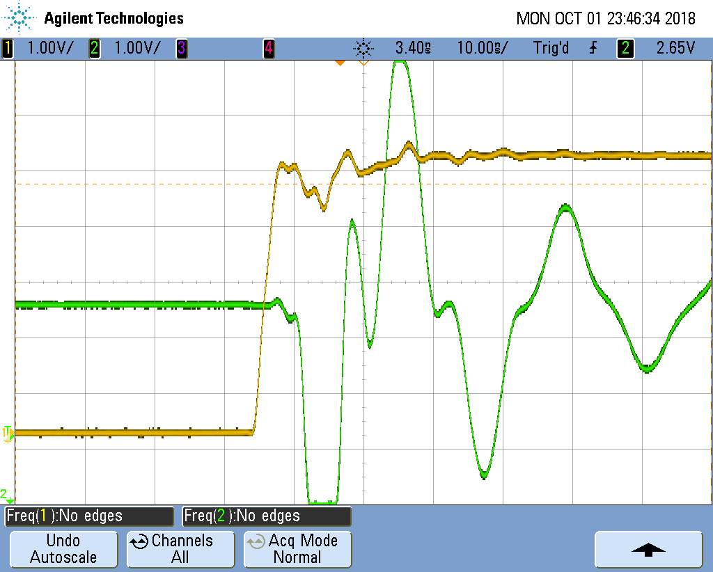

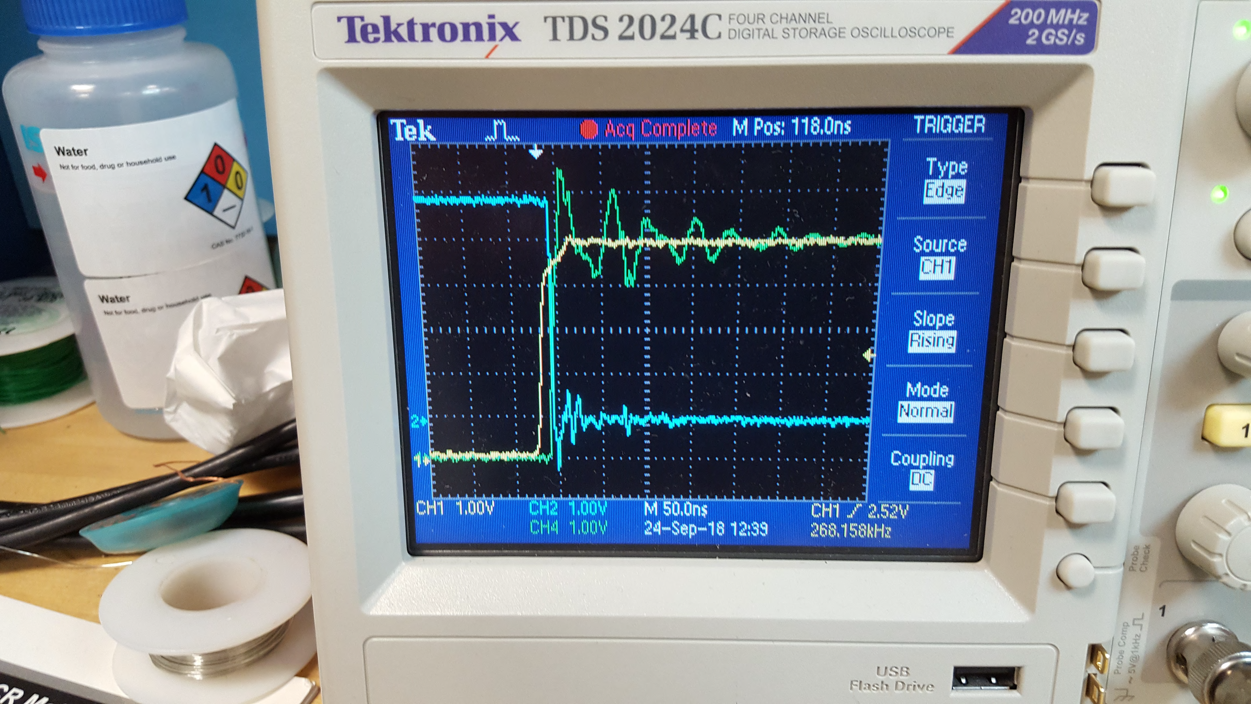

I am trying to use a SN74LVC1G74DCUR as a frequency divider. I have pins 6, 7 and 8 all tied to +5V. I have pin 2 shorted to pin 3 and a 5V, 125 kHz clock attached to these pins. The output is just very small blips
Any hint would be greatly appreciated!
