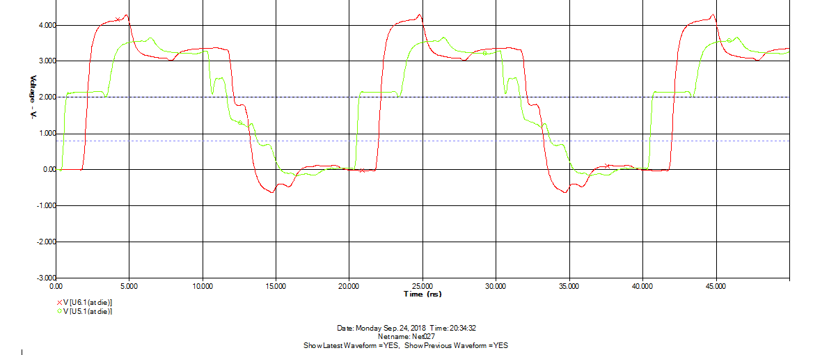

I am Using SN74AVC8T245DGVR part in my project.
Actually this level translator output is connected to receiver section and having a trace length around 6.7 inches approx.
Operating speed will be 50 Mbps.
Can you please suggest what is the maximum trace length for this level translator??
Any terminations are required for this??

    Thanks for your inputs.

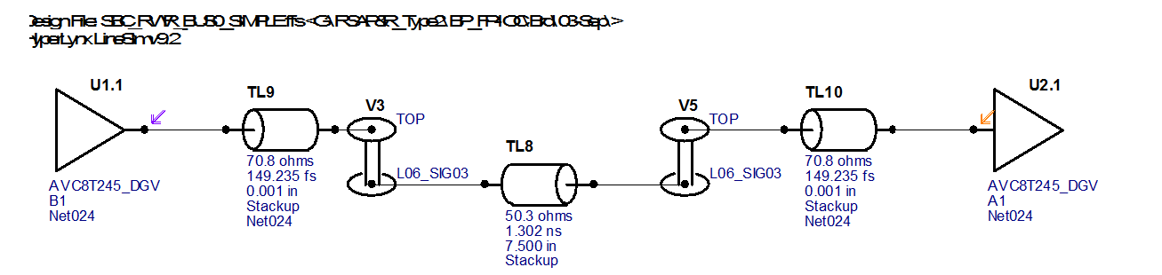

    Actually this buffers are the in between motherboard and daughter card(24-Bit parallel bus).

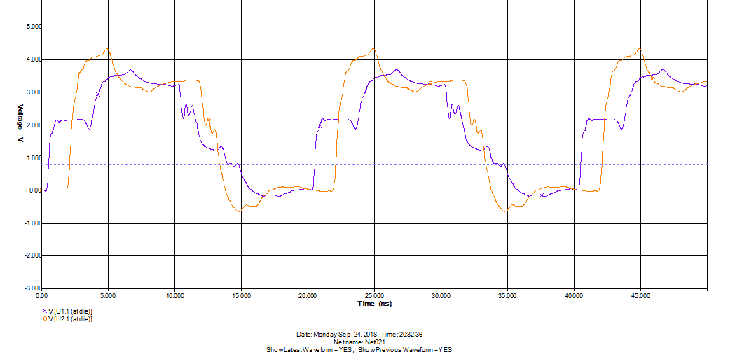

    I have simulated this buffer without including connector model by Hyperlynx9.2, Please refer below waveform at 50MHz
    I am not getting proper waveform its peak to peak around 4.9Vp-p. The same lines i have simulated with simple one transmission line, still i am getting the similar problem,
    Please refer the below one,
    Model selected: AVCB164245_IO_33
    Can you please guide us to implement this with good signal integrity.

  • Hi Emrys Maier,

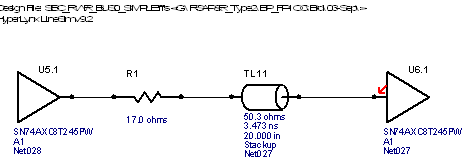

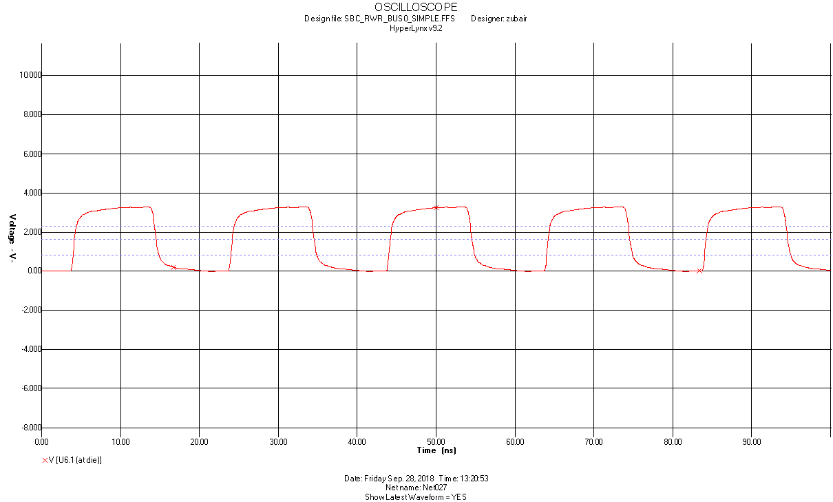

    I have tried with SN74AXC8T245 IBIS
    The results are,
    Voltage Vp-p upto 4.47V

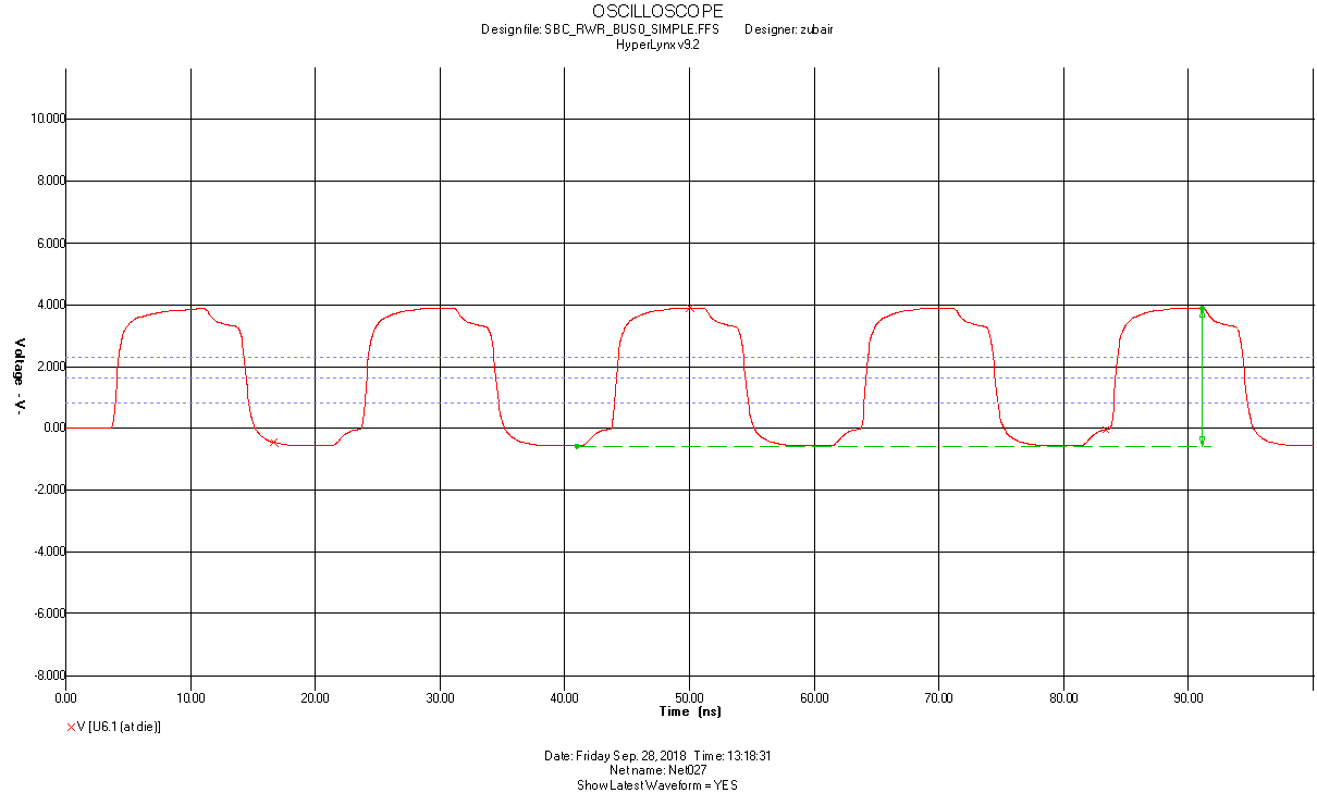

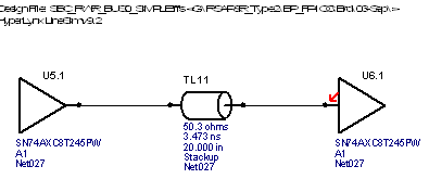

    With Series termiination:
    Voltage Vp-p is 3.31V.
    I have the following queries,
    1. The above mentioned part IBIS model is correct for our buffer ic validation ??
    2. In our current design we have 60 IOs with different length(Some IOs are nearly 20 inches length) is it required to  terminate all IOs??
    3. Between two buffers always requires any termination ??
    Ramesh M
  • It's likely that the AVC device's IBIS model is just old and doesn't properly reflect the operation of the device.
    Since the AXC is pin-to-pin compatible, I would recommend upgrading regardless, since the AXC device is better in all categories.
    To answer your questions:
    No, that IBIS model is specific to the AXC part, and does not perfectly represent the AVC part. As I stated above, I would recommend switching to ensure the best performance.
    It is never recommended to try to terminate a logic signal at the distant end.  This will cause a 50% reduction in signal (see: Ohm's law), and won't solve any of your problems.
    The most common method of eliminating reflections in a logic trace is to use damping resistors, as described in this application report:
    No, see #2.
