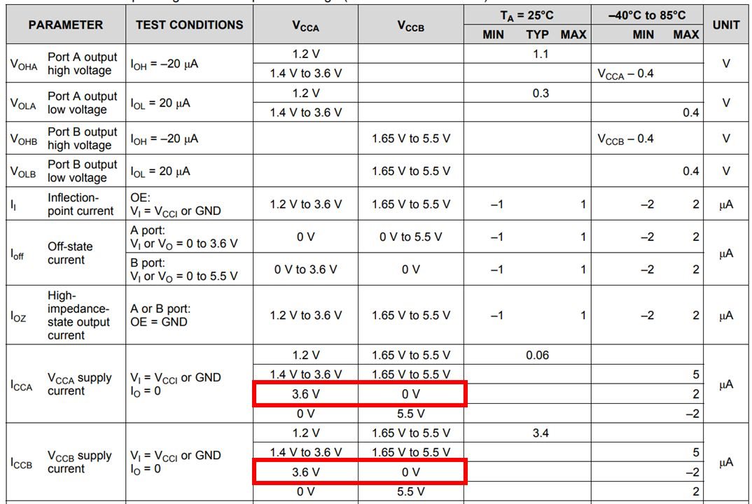

  • Hi ShreyasRao,
    Thank you for your comment. From this app note, I understand that the Vcca>Vccb condition can not be recommended. However the test condition of ICCA and ICCB in electrical characteristic show Vcca>Vccb condition as below. The customer may understand that you allow to use this condition. But is your answer still that Vcca>Vccb condition can not be recommended?

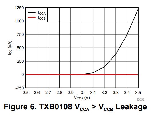

  • Hi ShreyasRao,
    Here is the Fig 6 from app note "Biasing requirements for TXS, TXB and LSF". This shows that ICCA goes up > 1000uA at VCCA=3.5V and VCCB=2.5V. However the electrical characteristic in datasheet show that the maximum ICCA is 2uA at VCCA=3.6V and VCCB=0V. Please let me know the reason of this difference.
    Satoshi

  • Hi Satoshi-san,
    Definitely, the normal operation will not be recommended.
    Vccb at 0V, will put all the IOs are in hi-Z. According to the datasheet, the Iccx current will be limited. I will do some more research on this and get back to you. I will see if there are any char data available in this regard.
  • Satoshi-san,
    on the datasheet section 10, for power supply recommendations, it mentions that the same statement regarding the outputs in Hi-Z during OE being low or either of the supply Vccx low(0V). It does not mention anything more about Icc except for the electrical char.
  • Hi Satoshi-san,
    I researched more into this and you can do it at Vccb at 0V and Vcca > 0V without negatively affecting (increasing ) the current consumption.
