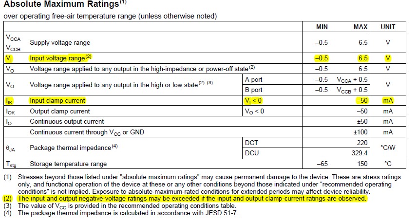

I'm trying to find the input current specs for A1 & A2 given the qualifying input voltages on the datasheet and it is not obvious to me. Are they on the datasheet, and if so; what symbol are you using?

The Vi, and Iik are the relevant specifications for input current in the absolute max section of the datasheet.
The input can go below ground if the Iik spec is satisfied. The input is not allowed to go above 6.5V regardless of current.
You can see this app note for more information.
