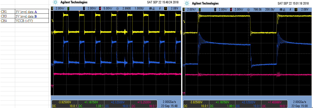

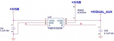

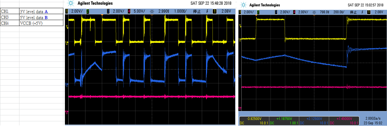

My customer is using TXB0101 as translator between one wire command host and LED string(LED on chip). Schematic is shown below. And they tested with LED string then waveform seems like distortion shown below(also normal waveform which is before installing LED string and also test with high temperature by hair dry). Could you give us any idea on this case?
P.S. They use the same architecture with our SN74LV1T34 and there is no error or weird waveform be seen.
