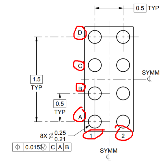

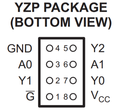

Part Number: SN74LVC1G29
there is a discrepancy in the naming of the pins for SN74LVC1G29 in the datasheet (see below)
