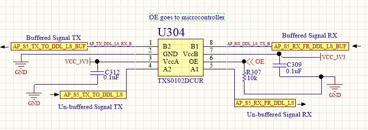

TXS0102: Any reason why the circuit below wouldn't function?
Part Number: TXS0102
Other Parts Discussed in Thread: SN74LVC2G34
When checking the output of the device, the lows don't go to zero volts. The ground is fine and the VCC bot are going to the same 3v3 rail. the circuit is shown below.
thanks,
JP
  • Hi JP,
    The TXS family parts will not go to 0 V if the input doesn't go to 0 V. These devices are suitable for open drain applications and I am assuming it is draining current down your input buffer which is causing a voltage that is above 0V. This device does not act as a buffer.
    This FAQ talks the differences in the auto bidirectional families. e2e.ti.com/.../719537
    This is our training page with videos on the LSF family which is very similar to the TXS family for you to learn more about designing with it. training.ti.com/TLM-LSF-Intro
    It seems like you are inputs are not changing direction, so do you think a unidirectional buffer could work for you? That would get rid of your issue of not reaching 0V. Maybe the SN74LVC2G34 could work? If you let me know your requirements, I can help find a partnumber.
    Thanks!
    - Karan
