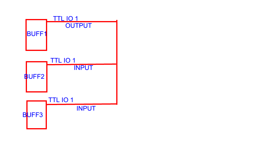

TTL BUFFER OUTPUT LINES SHORT
In my digital board iam using three SN74LVC8T245PWR chip for TTL IO Configurable signals, after implementation iam tested the 24 TTL IOs in auto mode test by  a single short circuited connection between the three corresponding TTL IN/OUT 1 of the 3 Buffers, similarly for TTL IN/OUT 2- TTL IN/OUT 8 of all buffers. Out of these shorted three IOs one will act as output and remaining two will be input, likewise i validated(both as input /output) all 24 IOs by 3 iteration.here any issue will happens when at a time two TTL IO become OUTPUT???????
Kindly provide the feedback
