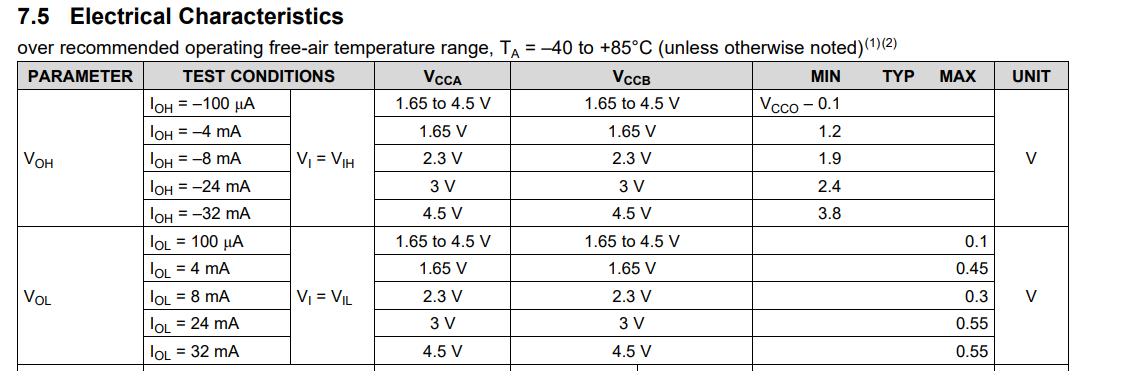

SN74LVC1T45: Driving capability
Part Number: SN74LVC1T45
Hi Team,

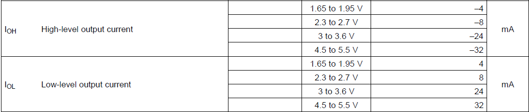

Just a simple question, I would like to know how much current drive capability this device has.
From below spec, I just want to understand, when VCCO is 5V for example, output current can be 32mA max correct? But how do I determine what VOH will be at 32mA?
Customer wants to understand how to determine the drive capability of this device, or is this kind of logic device made for current drive purpose? thanks!
Andrew
