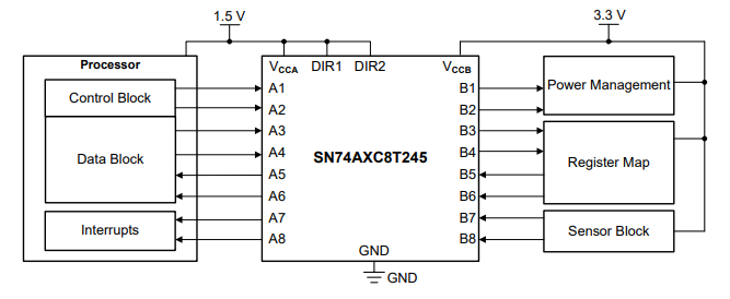

Hi Team,
The datasheet says: The VCC isolation feature ensures that if either VCC input supply is below 100 mV, all level shifter outputs are disabled and placed into a high-impedance state.
Here is the application: 1.5V is for processor and VCCA, 3.3V is for VCCB.
In the beginning,  /OE is connected to GND, A1 is input and B1 is output. Processor is set to high on A1, so B1 is high.
Then /OE is connected to 1.5V, when 1.5V for processor and VCCA powers off, what will B1 be? Is it still keeps high?

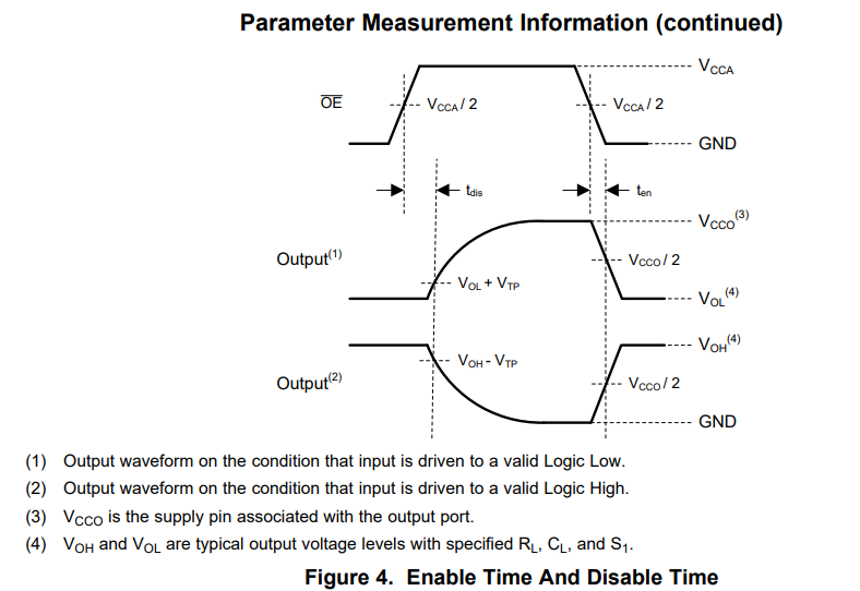

What does the figure 4 mean in the datasheet?

  • When the OE input is driven high, or when at least one VCCA/B is off, then all outputs are disabled. If there isn't another device driving that signal, and if there is no pull-up or pull-down resistor, then the output will be floating.
    Figure 4 shows the timing of an output that is being disabled, and that is pulled by a resistor in the opposite direction than it was being driven (see figures 1/2).
