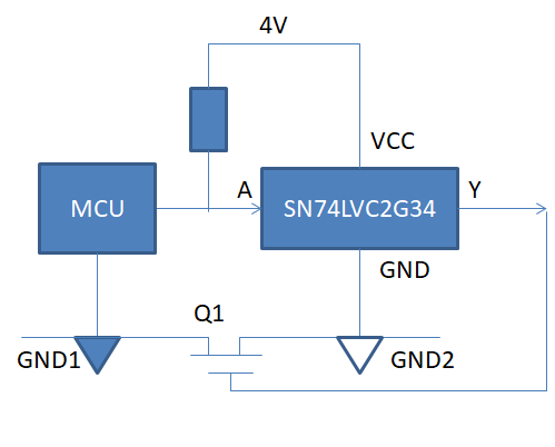

Hello there,
We have a circuit need a buffer to drive a MOS Q1 to disconnect GND1 and GND2, as below.
My concern is what will SN74LVC2G34  output if it's GND is floating after Q1 is turned off? Will it damage SN74LVC2G34? or the output of SN74LVC2G34 is out of control?
