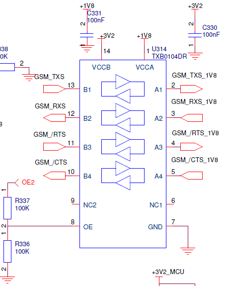

I am using TXB0104 for uart conversion from 1.8V to 3.2V.  Initially the level conversion of constant high signal is happening. But when a data bit is sent, it starts to generate a series of sin waves as noise and settles after some 30 sec or 1 min.  Please help me on this. I have attached the schematic of it for reference.
Note: No pull ups are there on UART lines. Do we need to put them?. On one end of TXB IC there is GSM controller and on other end its open to an external connector.

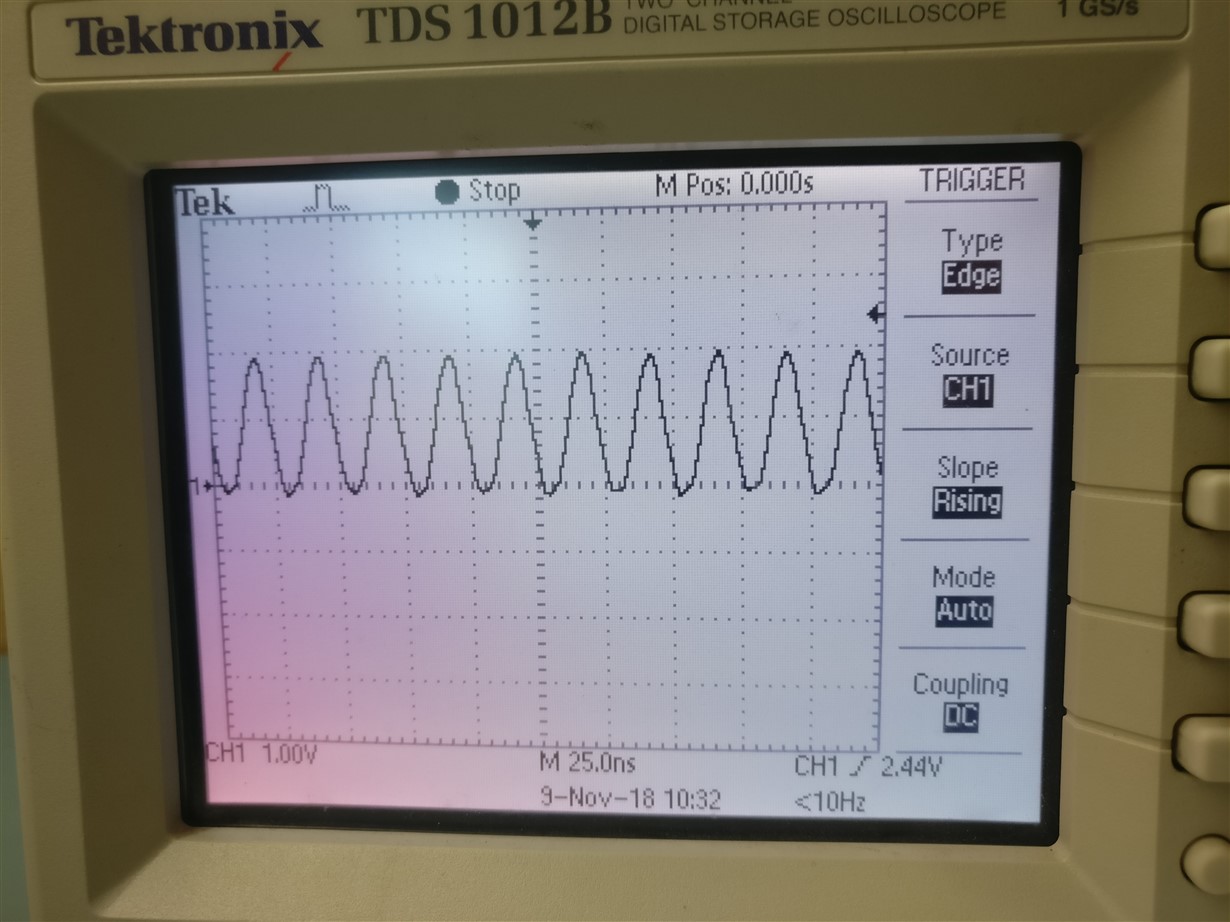

    At 1.8V side

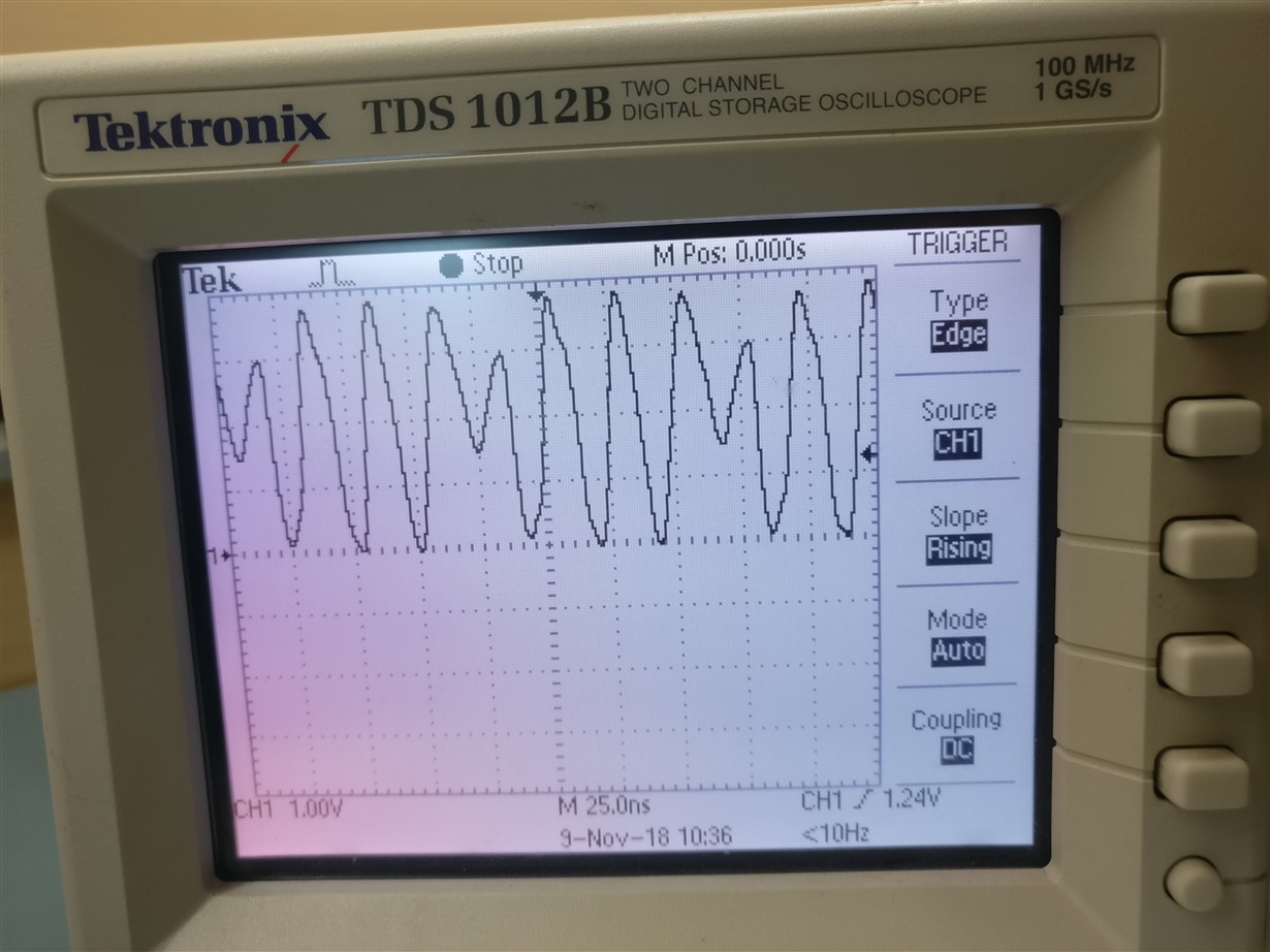

    At 3.3V side
    Please note, initially a when Rx is high, I am able to see the level shift happening, but when ever I am sending a data, thats when this nosie is observed.

  • Aditya,
    Thanks for the scopeshot provided.
    To me, it seems that there are reflections on the lines which is affecting the signal integrity. The reflected wave is overlapping with the incident wave, causing distorted signal every 3rd cycle. Referring to the datasheet section 11.1 on the TXB0104 datasheet, the trace lengths must be kept short.

    Aside from this issue, I also notice that the OE pin is controlled with a voltage divider. What is the OE level? I would advise against using the voltage divider at OE assuming that the OE2 signal is at 1.8V?
