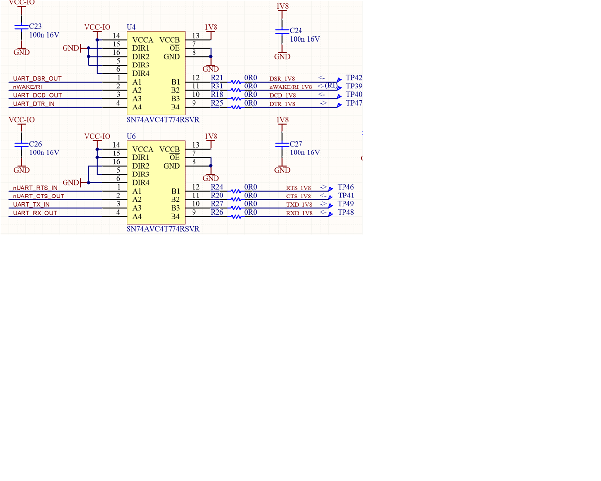

Hi we have trailed 30 units successfully over 4 months of continuous operation using this part however in our first run of production boards we have found an issue with around 40% of the first 500 units. The SN74AVC4T774 has failed and this manifests itself in a verity of ways. First unit had an open circuit between the input to output direction (VCCA to VCCB) and the second looked at so far has a short pulling down the modems UART to ground (VCCB to VCCA). Below is out circuit in this section with 3V3on VCCA and 1V8 on VCCB. In the design VCCA is always powered on but VCCB gets cycled if there is a connection fault with the modem, say 100 times over three months from first units. This batch is different to the last the first batch used for the 30 boards has code ZVK73J the 500 has a code ZVK74J. the boards were loaded by a reputable supplier with the correct heat profiles and the chips came from Digikey. Have you ever seen this issue before please ?

    The open and short issues, do they happen to all channels or are there certain channels that are affected? I see two devices in the schematic, both devices exhibit the same issues? When VCCB is cycled, are the inputs being driven? Lastly, would I be able to get scope shots of a working board and non-working board?
    I haven't seen an issue like this. The open you are experiencing could be attributed to the device being in a high impedance state. The short issue may be possible damage to the device, or a leakage path from the ESD protection. I'll go ahead and order some sample in case I also need to run some bench testing.

    Hi no only on certain channels
    No only one of the two IC’s so far
    Yes my belief is the on the VCCA side the inputs would be hi as the micro controller uart is idle hi
    Scope shots I can supply today thanks
    Is having OE tied to gnd  always a problem ?
    Cheers
    Jason

  • Hi Jason,
    Could you specify which channel? Or is it a random channel for every failing device?
    Could you also specify which device is the one that is failing (U4 or U6)?
    I don't see anything wrong with the schematic. To your question, connecting the OE pin straight to GND is done quite often. We recommend to pull it up to VCC with a pull-up to keep the device in high impedance during power up and power down, but that would require an addition control pin to drive it low. Because of this, many people just tie it to ground to avoid using more I/O pins. It's possible like I said that the internal ESD structure could have been damaged causing the short.
  • Hi sorry for the late response however I have just come off the production line where we had the issue.
    Both U6 and U4 were failing and the damaged channels seem random sometimes opens sometimes shorts.
