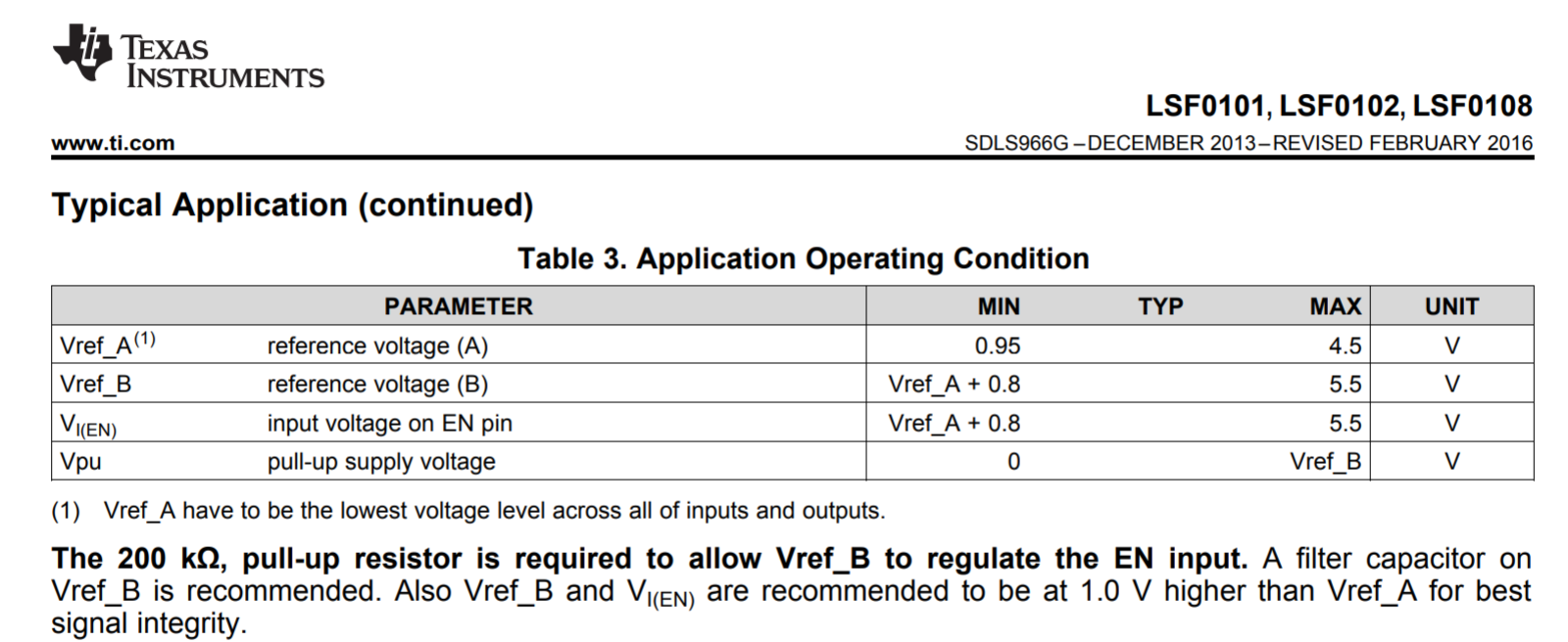

    I would like to reiterate, I need to translate SDA/SCL I2C logic from one supply of 3.3V to another supply that varies from 2.4V to 5V.  Reading through the datasheet of the LSF0102, it looks like VREF_A must always be lower than VREF_B: see picture below. This is not acceptable for my application. Is there a way to get around this?

  •  Hi,
    Sorry I did not watch the video. It looks like the VREF_A side is being generated using a resistor divider set to the lowest voltage in the system (2.4V). What exactly is going on under the hood? Meaning what do the circuits look like on the chip that are driving the A1 and A2, and what are their power rails?
    Luke
  • In other words, can we do the same thing (add the R1 and R2 to VREF_A so VREFA=2.4V) with the original TXS0102? If not, why can't we do it with the TXS0102 and why can we do this with the LSF0102?

  • Hey Luke,
    The other videos in the series go through every single transistor in the device. I couldn't explain it any better or faster here.
  • Hey Luke,
    Sorry for the double reply -- I should have just put this in my first response.
    You asked why we can't do this with TXS0102. It's because TXS0102 is a __much__ more complex device than LSF0102. The TXS0102 has over 2000 transistors in it for internal logic. The LSF0102 has 3 transistors in it. I would highly recommend watching at least the first two videos in the LSF series. They should answer all your questions.
