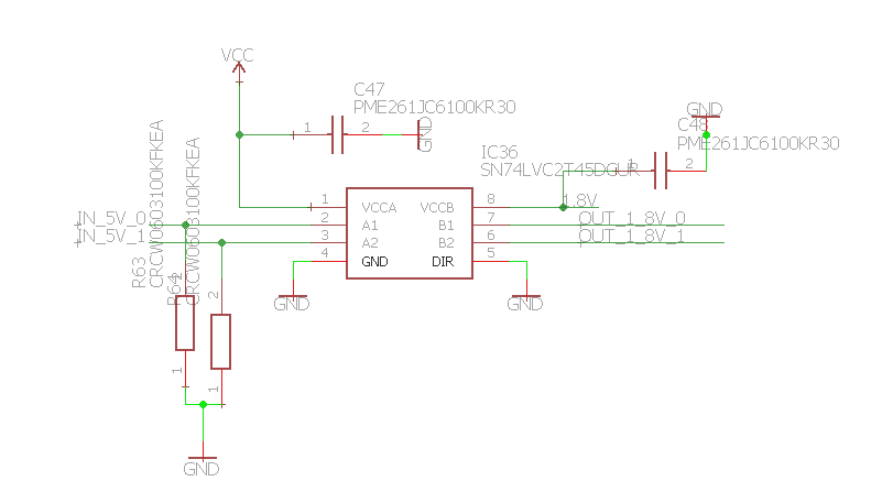

    Now if I was in the following configuration (with 2 5V inputs coming from a connector (sub for example) and I connect them directly to LVC2T45), should I need some pull down resistors (I take 100K in my example):
  • In this schematic, the LVC2T45 is configured with A1 and A2 as outputs (DIR = LOW), so the pull-down resistors are not required. If you configure the A1 & A2 pins as inputs (DIR = HIGH), then I would recommend using pull-down resistors to keep the inputs low when the connector is disconnected.
    I should note 1 other thing -- I would recommend adding external ESD protection between the connector and the logic devices. The internal ESD protection in these devices is only designed for manufacturing ESD protection -- most events from human contact are much higher voltage and can cause damage to the devices.
