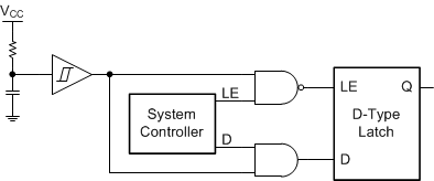

When starting up the SN74AC373, the LE is low but the Q outputs high logic, is this normal? Or does this mean logic high is the default output voltage level of this device?

Hey George,
My apologies for not getting back to you sooner on this. I have been out sick for a couple of days.
This is probably the simplest circuit to do what you need:
The circuit to the far left with a resistor, capacitor, and Schmitt-trigger buffer is known as a "Power On Reset" generator. There's a video that goes into detail on this circuit here:
Please let me know if I can be of further assistance.
