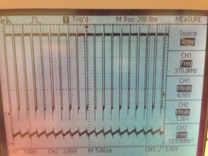

  • Hey sorry I got side tracked with another project.
    Gain is definitely the issue. When the frequency is set too high it seems like the parts start to regulate within the hysteresis region. Also when approaching this frequency the circuit becomes extremely sensitive.
    Both these problems are mitigated by daisy-chaining 3 invertors.

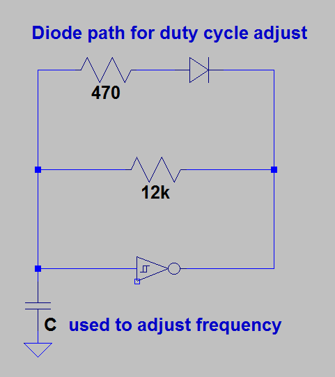

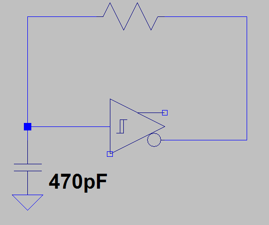

    Here is the approximate circuit:

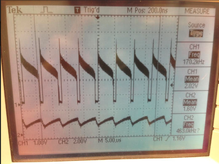

    Here is the output with just 1 inverter being used. This is about as fast as i can get it to oscillate.

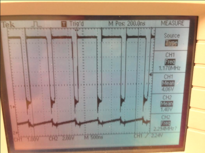

    Here is the output with 3 inverters daisy-chained using the same feedback circuit as above.
    The output is clean and the frequency jumped up.

  • It looks to me like the ringing on the output of the single-inverter oscillator is very large (about 1V, I think), producing higher frequency oscillations. That overshoot tells me that the gain is huge in either case. I would expect 30+ dB of gain at operating frequencies under 10 MHz.
    The overshoot is still there on the 3 inverter version, however it appears that having three stages adds enough delay to prevent those oscillations from looping through all three stages.
    You could try directly damping the output of the inverter to limit the overshoot. Typically, adding a 25ohm resistor in series with the output of the inverter will be sufficient to reduce the ringing.
    Can you get a scope shot of the rising edge at a faster time scale, maybe 100ns/division? Looking at them on a 5us scale makes it difficult to tell what's really happening since the inverter responds so quickly.
  • Ok. for the 25ohms series resistor, wouldn't the 12k do the same job as to damping the oscillations. Do you mean put the 25ohm right at the output pin?
    Would a small feedback capacitor also stop the ringing? This would be a better option for me.
    Also, I tried this without the the diode path and got similar results so that is not whats messing it up.

    Here's another scope shot I took using a 500n time scale.
    This is 3 inverters in series @ frequency > 1MHz
