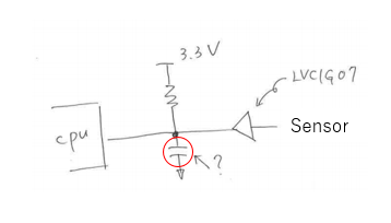

Part Number: SN74LVC1G07
HI,
Can you please let me know the capacitor capacity which can be driven?
HM
HI,
HM
The absolute maximum ratings allow 50 mA, so if you add a current-limiting resistor, the capacitor can be infinitely large.
