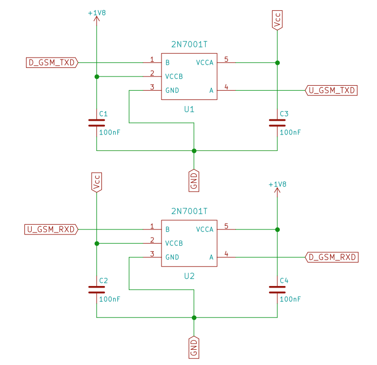

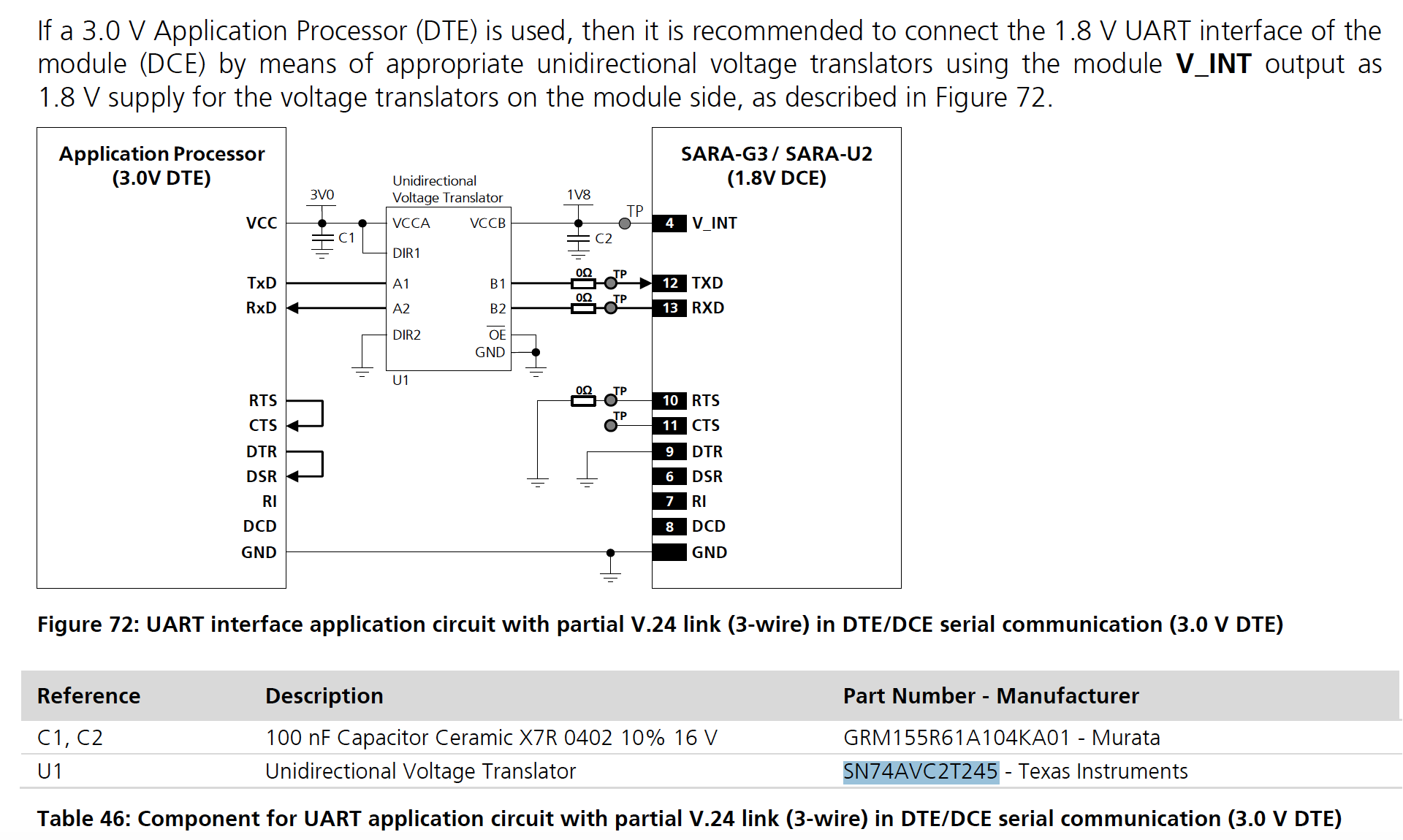

I'm trying to replace a part recommended by uBlox and was wondering if TXS0102 would be a proper replacement to avoid the direction pins circuitry altogether.
The circuit I'm interested in is the following (copied from uBlox SARA-G340 integration manual page 130):
Many thanks for your comments.
