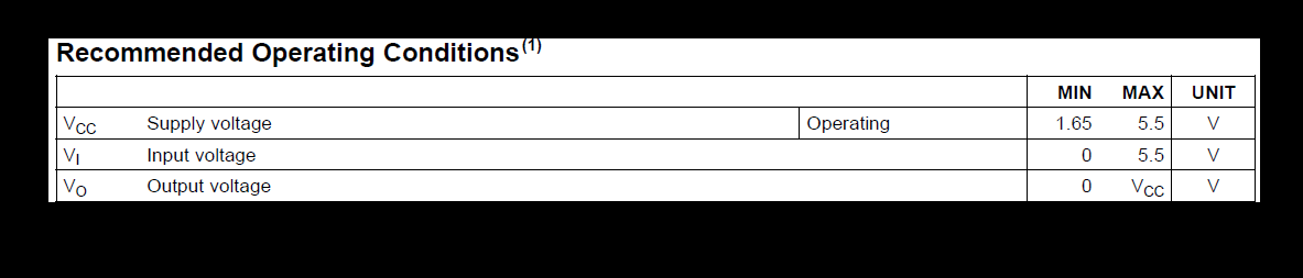

In our design we are using SN74LVC2G17 as a buffer.
1:As per datasheet it is mentioned that input voltage at a pin is 5.5V.
   Need to know if we are considering the Vcc = 3.3V still it is 5.5V tolerant.
2:Need to Understand V.IH and V.IL levels vlaues i.e min and max.
As per datasheet there are 2 levels for V.IH and 2 Levels for V.IL.
i.e min and max.
Here they have mentioned voltages for VCC=3V .
We are considering Vcc as 3.3V.
what levels should be considered while interfacing.
3:Please specify any formula or good appnote for it to understand.
