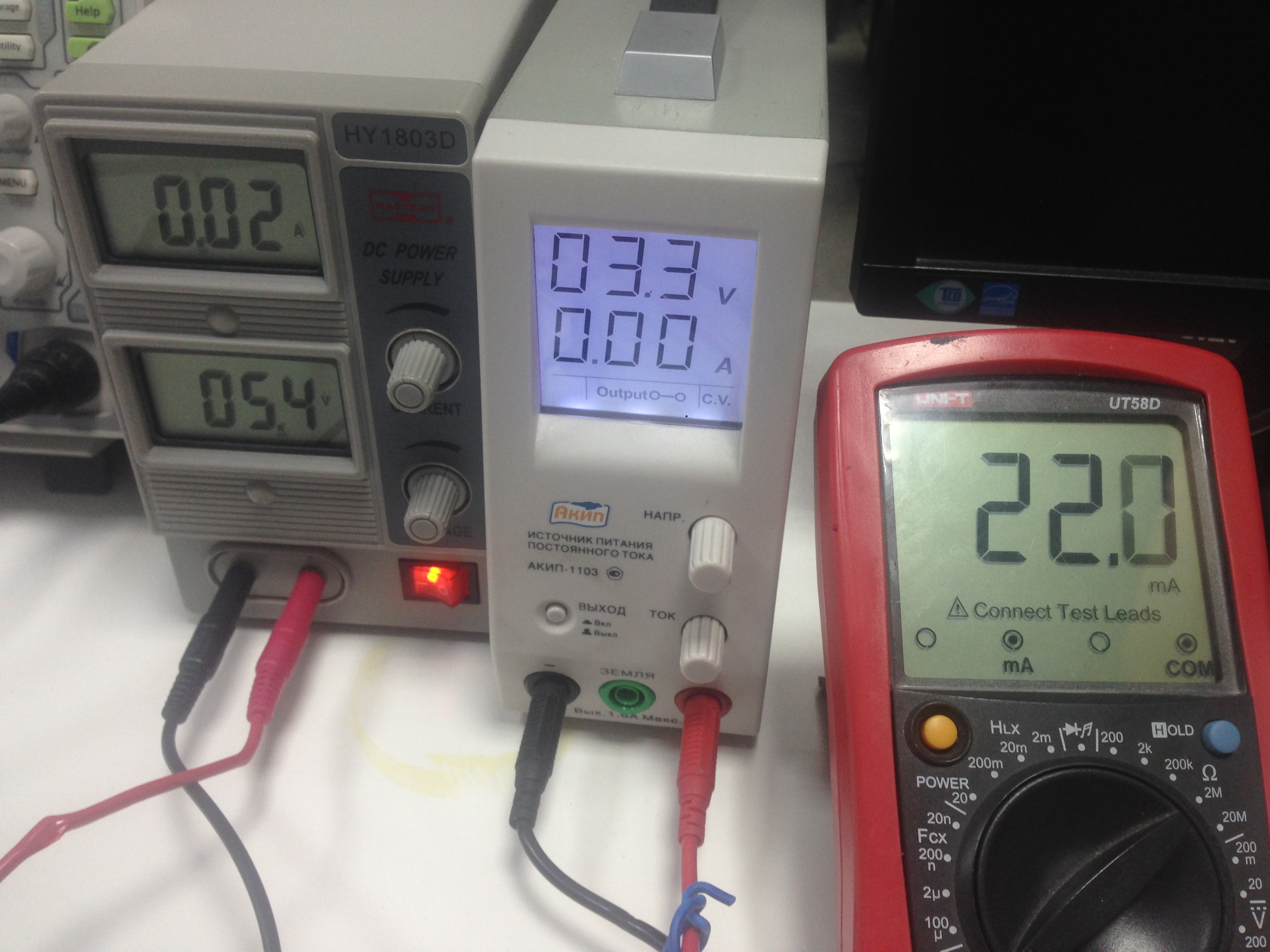

Hello!

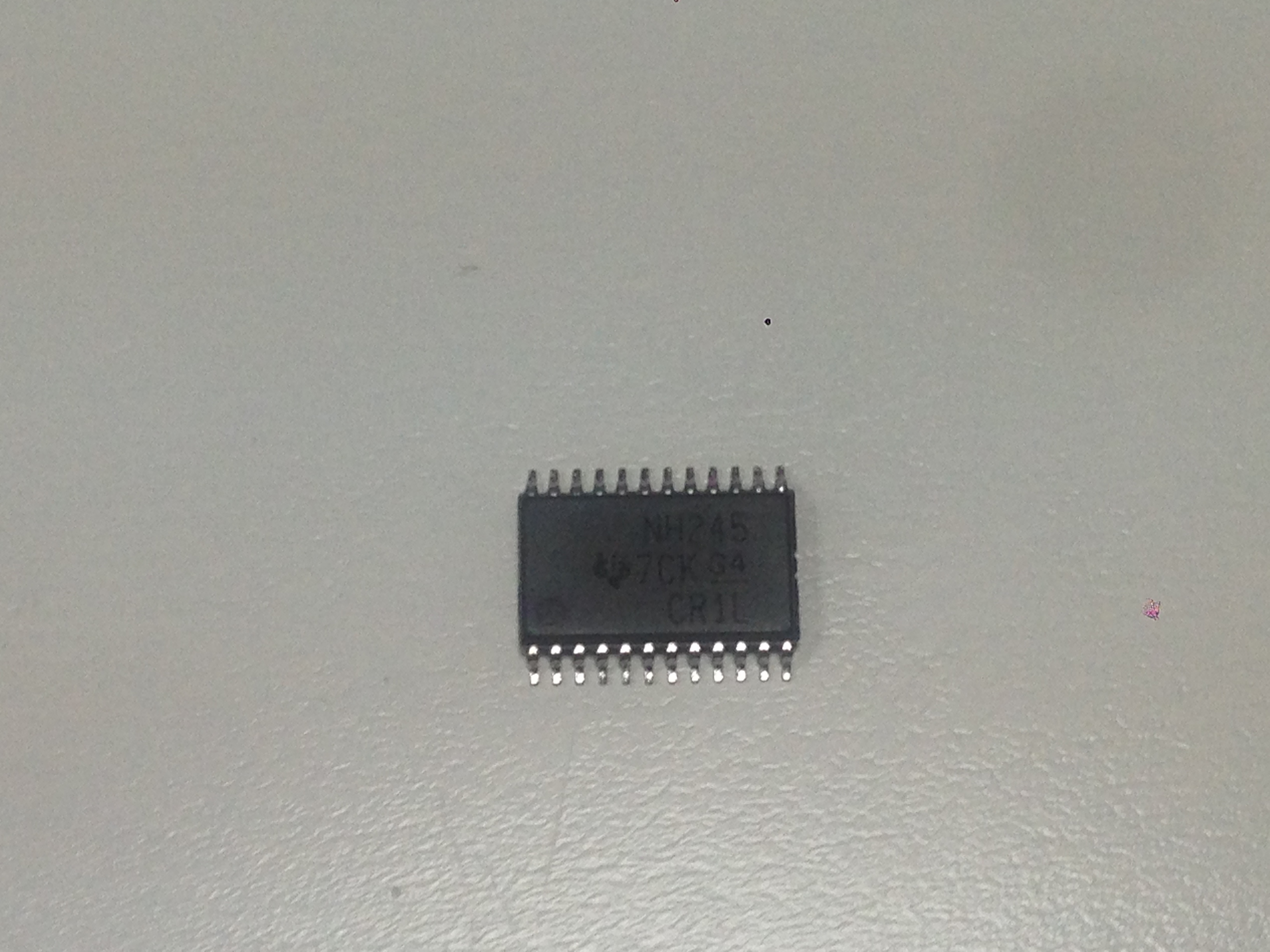

I have some trouble with SN74LVC8T245.

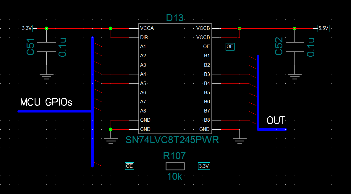

I connect it as shown at scheme.
But my device began to consume too much current, when OE is high.
After the tests on my PCB board, I connected this chip separately to eliminate any effect of the PCB and got the same results.

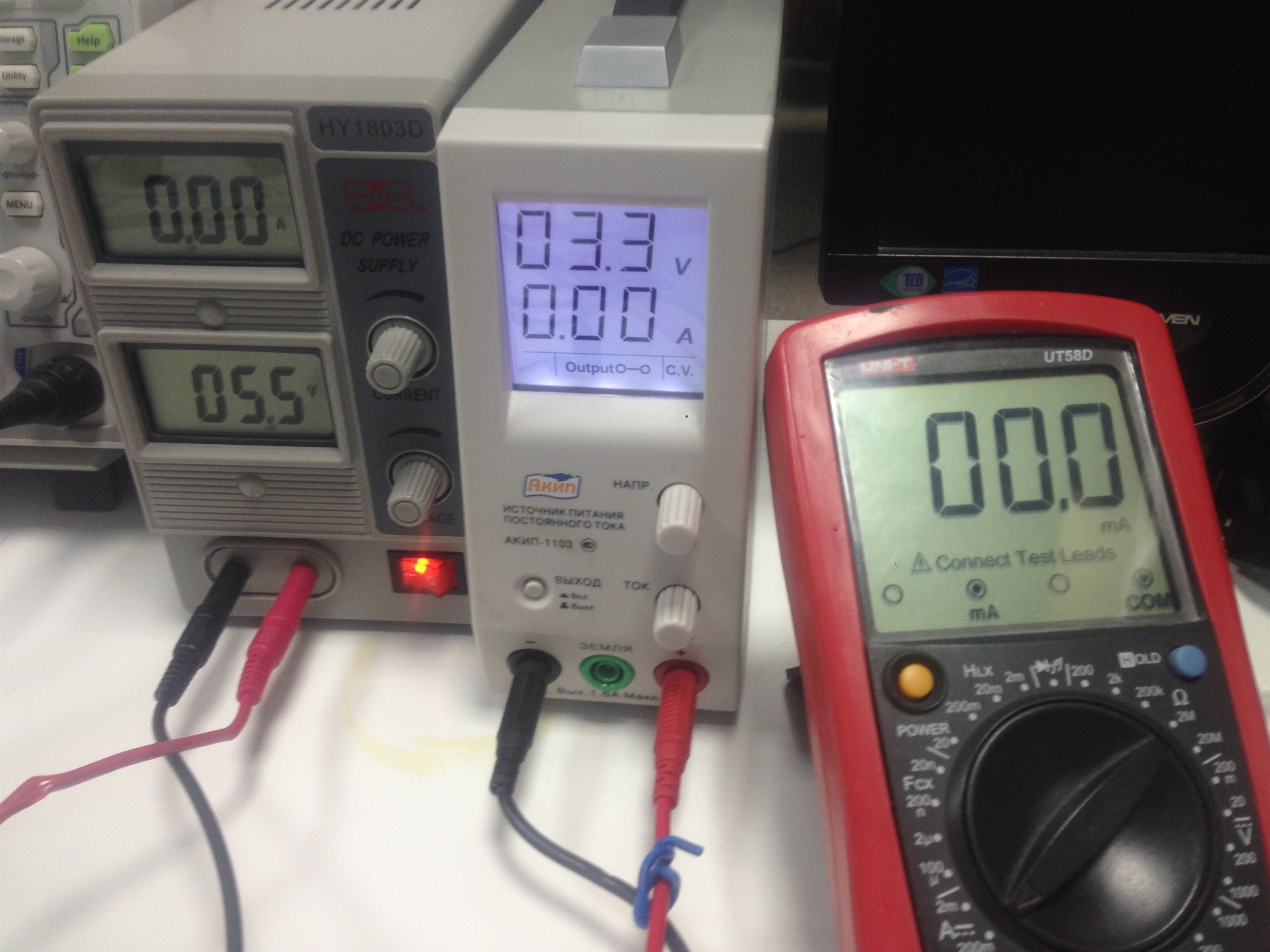

Tests with this IC (Ampermeter at Vccb):
1) Vcca - 3.3V, Vccb - 3.3v, DIR connected to Vcca, OE connected to Vcca
2) Vcca - 3.3V, Vccb - 5.5v, DIR connected to Vcca, OE connected to Vcca
3) Vcca - 5.5V, Vccb - 3.3v, DIR connected to Vcca, OE connected to Vcca
4) Vcca - 3.3V, Vccb - 5.5v, DIR connected to Vcca, OE connected to GND
5) Vcca - 5.5V, Vccb - 3.3v, DIR connected to Vcca, OE connected to GND
6) Vcca - 5.5V, Vccb - 5.5v, DIR connected to Vcca, OE connected to GND
Why does high current consumption occur at high OE levels and Vccb > Vcca (outputs disable)?
  • Hi Egor,
    The device being powered up with the OE high, would isolate the A/ B channels from each other(Hi-Z).
    The input circuitry on both the channels (A & B) would still be active and would need to be defined so that it would not float to a value closer to the threshold (Vcc/2). Would it be possible to have a weak pulldown on the channels and see if it reduces the current consumption?
    Is 3.3 to 5.5V translation required or is it anything lower?
  • Thanks for your reply.
    Yes, I need 3.3 to 5.5V translation. By the documentation the maximum voltage value is 6.5 V, so I decided that 5.5 still is on the upper edge of the safe range.
    I tried to add 100 kOhm pulldown resistors at IO port on both sides and current has become within the expected level. Thank you for your advice.
  • That is good to know, Egor.
    Thanks for the confirmation.
