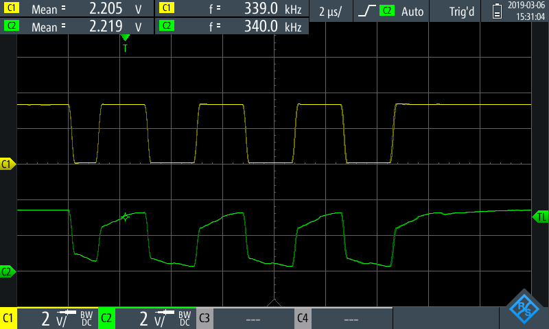

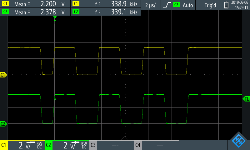

Hello Support Team
I have a need for a 6 - bit high speed bidirectional voltage translator. On one side, I have a CPU powered with 3.3 V, and on the other side is a target device with adjustable power 3.3V or  5V. I tried using TXB0106 but there is a signal distortion. Please see attached pictures, CPU on A side of translator is sending a 500 kHz signal, on both sides VCC is 3.3V, C1  is A1 pin  and C2 is B1 pin of TXB0106, PIC1 are signals without target connected (looks good) and PIC2 are signals with target connected (there is a distortion in signal on B side). Can you tell me what is causing signal distortion?
Can you please recommend some of your other devices suitable for this kind of a design? There can not be any pull-up on the data lines, possible pull-down resistors.

  • Hi Nenad,
    Please refer to the app note on external pulldown / pullup on the TXB devices. It looks like the external pulldown combined with the capacitive loading is causing the signal integrity issues here.
    www.ti.com/.../scea054a.pdf
    I would recommend switching to direction controlled transceiver like the SN74LVC8T245 for the 3.3 to 5V support.

  • Hi Shreyas,
    Thank you, I think your answer is right for the TXB0106 problem.
    Thank you for your suggestion, we actually have a working solution with SN74LVC1T45, we are trying to avoid using direction control.
    In this application we need separate direction control for every signal, which is a lot more MCU pins we need to use.
