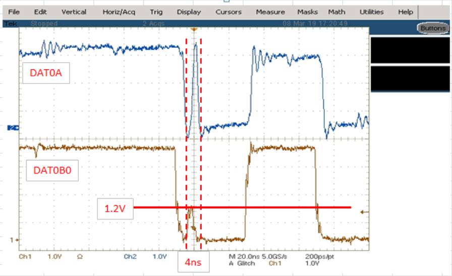

Hi team,
The customer observed access error to SD card when 1.2V/4ns noise has just come to DAT0B0. At the access error, DAT0A level was 3.3V in spite of being expected low level. We think the one-shot circuit inside works around Vcc/2 so the DAT0A should be still low level if the 1.2V noise is input to DAT0B0. Please see below screen-shot from the customer, and let us know the reason why the DAT0A is changed from low to high by just 1.2V noise?

    The 1.2V level is greater than the Vil level and hence cannot be considered low. Do you know why the input had the 1.2V signal and any way to avoid that?
    The one shot circuit we assume that the trigger point is around ~Vcc/2 but we cannot or it is not guaranteed on the datasheet.
    why is it not being seen on the other waveform?
  • Hi Shreyas-san,
    Regarding the 1.2V input to DAT0B0, the voltage stays between VIL(max.0.15V) and Vcc/2(1.65V, threshold of one-shot operation). In that case, what is the correct output voltage for DAT0A? Do you think why the DAT0A output becomes 3.3V by the 1.2V noise signal?

    The 1.2V signal is not noise. Noise is in the uV or the mV level. Beyond the Vil level, the device cannot guarantee the low state anymore can the oneshot can trigger below Vcc/2. Would placing a series resistor on the input line help in reducing the unwanted glitch at the input?

    Behaviour is indeterminate between Vil and Vih levels.
