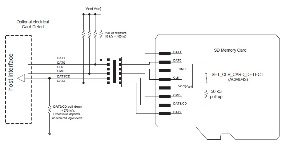

1) please can you tell us the difference between TXS0206A and TXS0206
2) which solution is better regarding EMI and ESD
a) TXS0206
b) TXS0206A + 2x TPD4E1U06DCKR
3) we see that the TXS0206 and TXS0206A has internal pull-up (40k) on all the DATA lines and CMD line
 in some designs we saw that also CLK line has pull-up is it necessary to add external 40k pull-up on CLK line?
4)  in order to use electrical card detect function on DAT3 line , it is suggested to use 270k pull-down on the line.
Do we have to add the 270k pull-down resistor on DAT3A and DAT3B side of the  TXS0206 or TXS0206A?
5) Also the card has internal 50k pull-up  on DAT3 which should be disconnected during regular data transmission with SET_CLR_CARD_DETECT command ACMD42
 The  TXS0206 or TXS0206A has pull-up on DAT3 line, is this ok ? Because when disconnect internal pull-up on DAT3 , there will be an pull-up in the  TXS0206 or TXS0206A.

  • David,
    I would recommend using the TXS0206A device.
    Both device have internal pullup and pulldown resistors and hence I would not recommend having external pullups or pulldowns on the line.
    The SD memory card internal pullup of 50kohm may still be fine, but if allowed, I would recommend disconnecting it.
    Read the app note of the effects of external pullups and pulldowns here(applies to TXS0206 devices as well) :
    www.ti.com/.../scea054a.pdf
