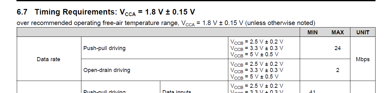

My customer want to find a device that can shift the voltage 3.3V to 1.8V of MDIO signal.
I search the previous posts, you recommend the TXS and LSF part.
But I find the TXS0104 only can support the 2MHz in open drain signal.
The data rate required by customer is about 20MHz.
So can you help to comment if the TXS0104 can support the level shift of 20MHz MDIO signal?
If not, please help to provide the suitable device for the application.
