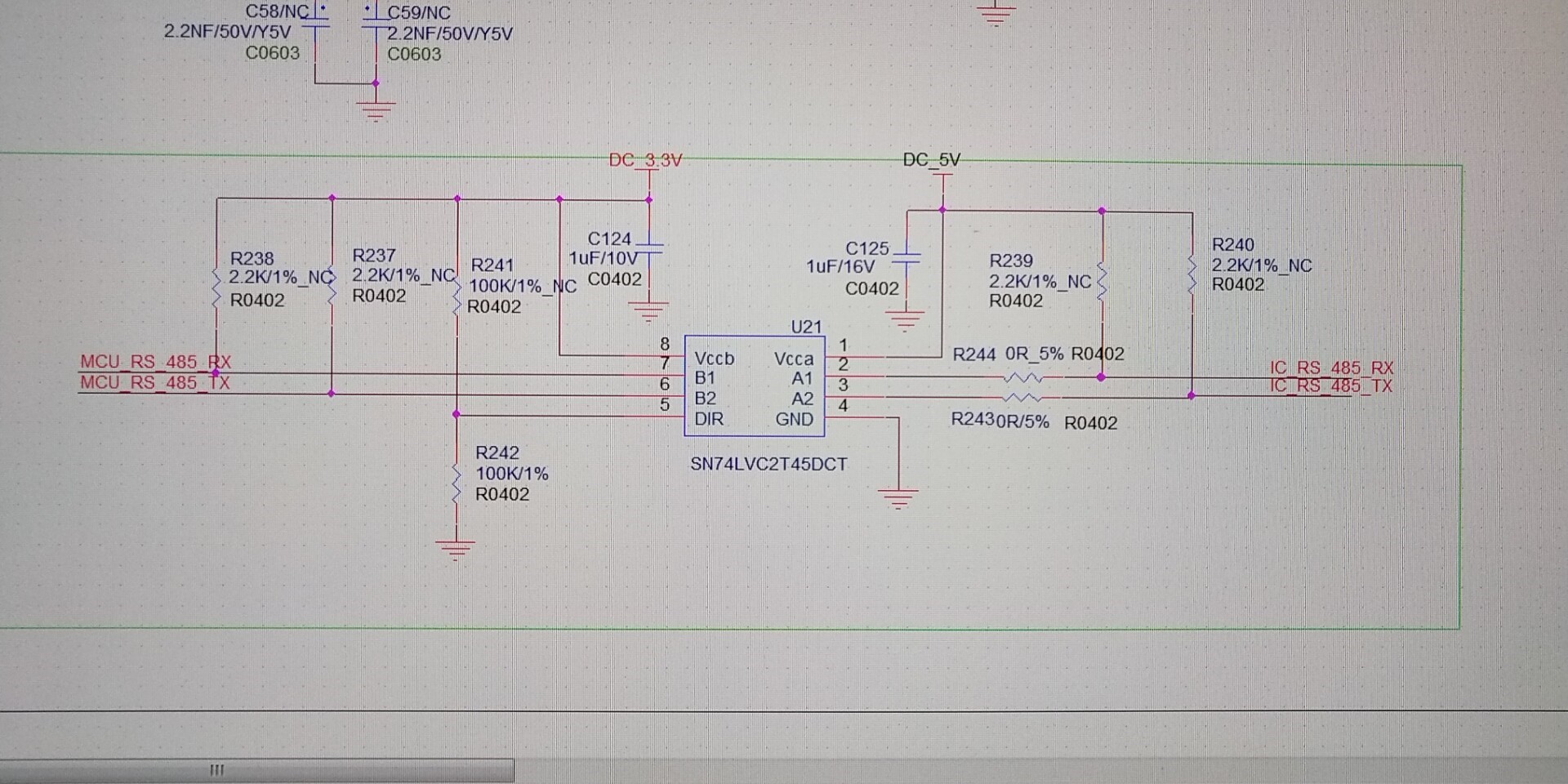

Customer use SN74LVC2T45 in the UART application, package is DTC(DUT). As DIR is connected to GND, this circuit can not work.
1. Do we have PIN to PIN bi-direction socket so we do not need redesign the PCB?
2. If not, can TXS0102 used in UART 3.3 to 5V level shift? Any better bi-direction recommend?
