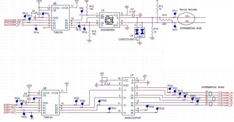

Problems when FCT test:
When ES+/- or Encoder _+/- changes from +5V->0V or 0V->5V ,RO or EQEP usually can't achieve +3.3V->0,somtimes remain +1.7v-2v。

    I see that there are pullup and pulldown resistors on the 5V side, what is the loading on the 3.3V side?

    Direct to Mcu,no other things.
  • Not test as your requirement,is there any test spec?+3.3v signals direct to mcu,nothing else.
  • What is the FCT testing spec?
  • Function Test in manufacture to verify the ic function.
  • Got it, so its the normal operation verification which is failing.
    I dont see the scopeshots. Do you know the ratings on the scope probes? 1Mohm, passive 10x probe? sometimes, configuring it as 50ohm and using 1X probe adds high loading which the device wont be able to drive or handle.
    If not, is there additional loading on the PCB which is not shown on the schematic?
  • We pull high by 10kohm resistor for TP11,then Tp10 can't achieve low. Tp10(3.3v signal side) direct to Mcu,Tp11(5v side ) direct to connector,nothing else.
  • I would recommend using the SN74LVC8T245 device which has stronger drive current strength (32ma) as compared to the TXB0104 (20uA).
    It can drive low and drive high effectively better than TXB0104.
