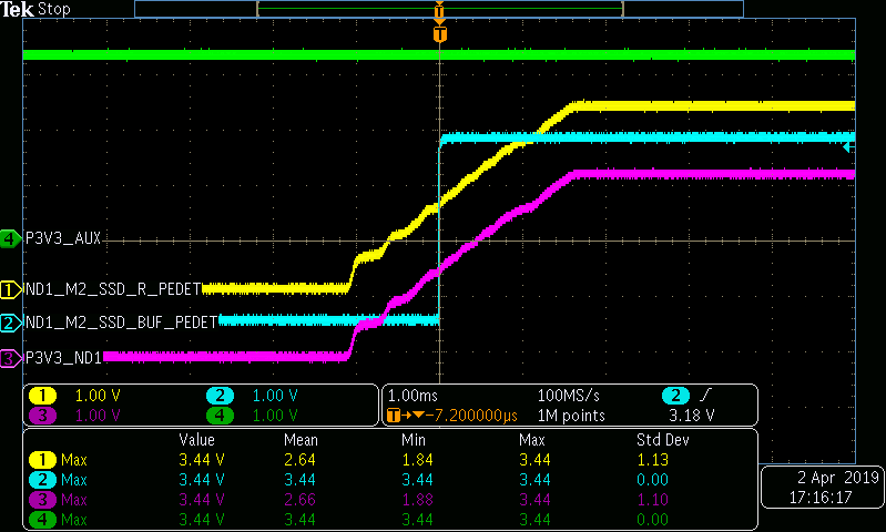

Hi Sir,
We found there are some strange peak waveform in below waveform situation,
And it may cause some issue in customer side, could you please help to comments on it?
Or we can add any workaround solution to avoid the peak waveform?
Diagram 1 is the measurement setup.
Channel 1: pin2(input)
Channel 2: pin4(output)
Channel 3: P3V3_ND1 (3.3 V power rail)
Channel 4: P3V3_AUX (3.3 V AUX power rail)
Waveform 1. When P3V3_ND1(CH3) turn on, SN74LVC1G07 output pin4 will output from low to high
Waveform 2. Zoom in from waveform1's SN74LVC1G07 output pin4 output from low to high
Before the SN74LVC1G07 output become stable high, it will have some peak waveform as below red circle when SN74LVC1G07 input is around 1.6V. and it will happened every time when output turn high from low.
