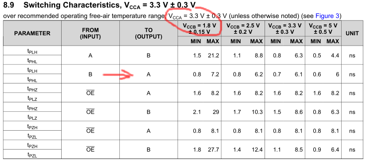

Hi Team,
I have a question on SN74LVC8T245.
I am thinking of converting from 1.8V to 3.3V.
Is 1.8V input on B side (Input) and 3.3V output on A side (Output) possible?
Is the condition VCCA <VCCB mandatory?
