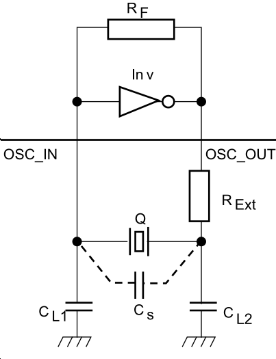

SN74AUC1GU04: Is it reasonable to build a crystal circuit with SN74AUC1GU04 chip?
Part Number: SN74AUC1GU04
I want to build a crystal circuit with the following topology using the SN74AUC1GU04 chip.But I have encountered some problems.Want to ask for help.
The SN74AUC1GU04 chip is powered by a 1.1V application in a 24MHz crystal circuit. Is this plan reasonable? What is its open loop gain? What is the appropriate Rf value recommendation?
