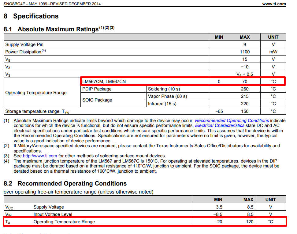

Part Number: LM567C
Is the operating temperature 0℃~70℃ or -20℃~120℃?
