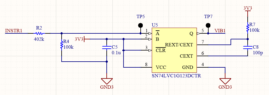

I'm currently having a problem using SN74LVC1G123 -- the output pulse isn't appearing. An image of it in my schematic can be seen below. I would like it to trigger on the falling edge of input A and output a pulse that is a little over 10 us long (I think the application curves place it at roughly 20 us, which is fine).

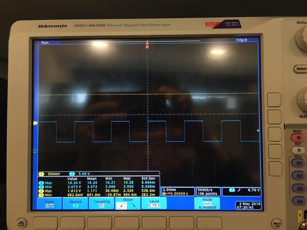

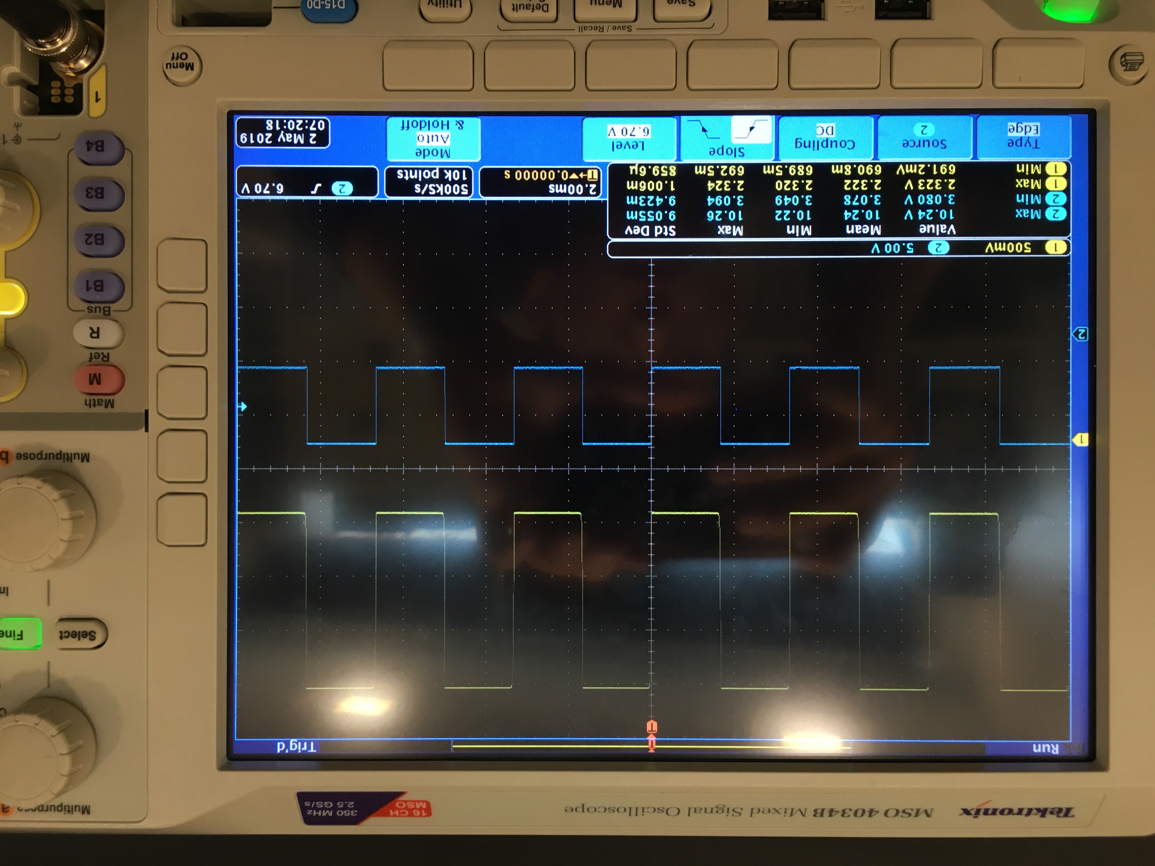

The "3.3 V" power supply is currently at a little under 3.6 V. The input, measured at TP5, is shown below on the yellow trace (sorry about the phone picture, didn't have a flash drive on me at the time). In both pictures below, the blue trace is the signal INSTR1, which is divided down by 1/4 (R2 has been changed to 301kOhm).
Based on the datasheet, I'm led to believe that this should work fine. The max of the input is 2.3 V (above 2 V), and the min is ~700 mV (below 800 mV). The output, measured at TP7, is shown below.
The output, for whatever reason, is at a DC ~1 V. Can anyone let me know if there's something I'm doing wrong? If more information from my end is needed, let me know and I would be happy to oblige.

    It looks to me like your schematic is correct for producing ~10us pulses at every incoming falling edge. My initial thoughts are that it's very odd to see 1V at the output -- this indicates a circuit problem to me, since the output should be actively driving either 0V or VDD (~3.6V). Is it possible that there is an error in the wiring of the device? Or perhaps there's something else driving the line?
    I'd double check the pinout, orientation, and look for any solder bridges or other circuit problems, especially around pins 5 and 7.
    You can also monitor the voltage on pin 7 to see if the capacitor is being discharged correctly with each falling edge -- this device operates by discharging the capacitor when there is a trigger, then monitoring the recharge to get the timing of the output pulse.

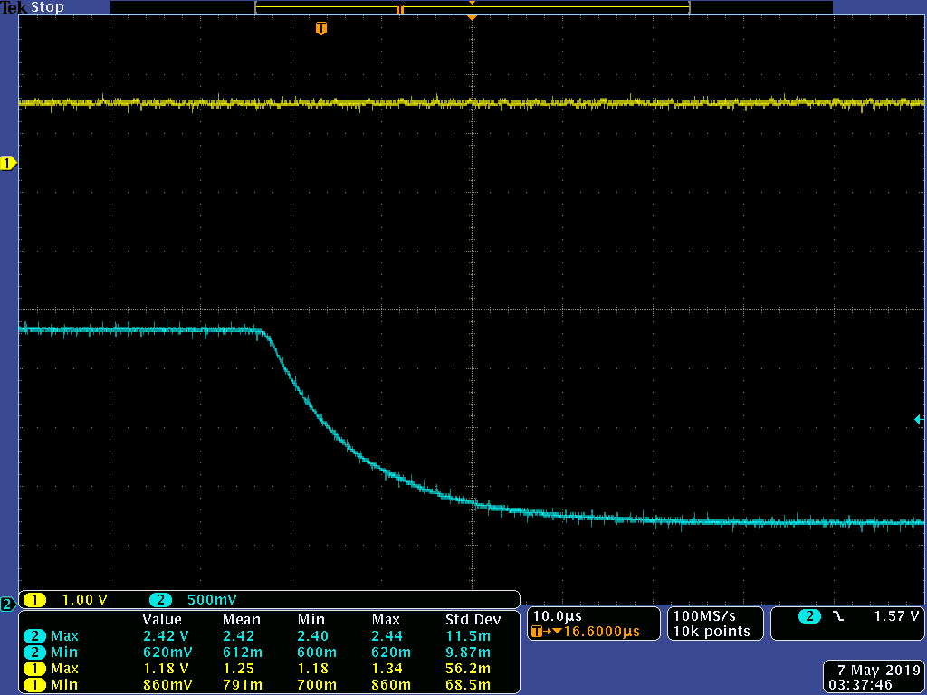

    For the sake of completeness, below is an image again of the output of the multivibrator (yellow) and input (blue), this time zoomed in significantly on the time axis. The falling time of the input isn't too slow or anything for the multivibrator, right? It only needs to cross the low logic level?
  • The slow input signal is OK for this device since it has Schmitt-trigger inputs.

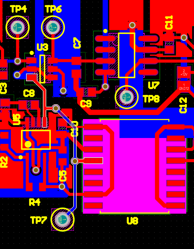

    This may be beyond the scope of how much you can help me, but I've attached my schematic below. I'm curious to see what else you think could be the source of my problems. Below is a small snippet of my layout showing the only places in which the output of the multivibrator (U5 on the left) is connected (pin 3 of MAX4648, U3, and pin 4 of ISO7810, U8).

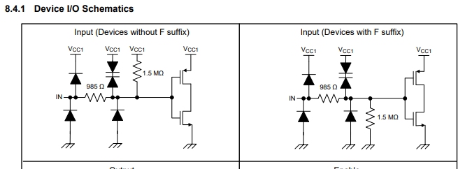

  • I doubt the input current from the ISO7810 would be a problem for the SN74LVC1G123 -- the LVC family of devices can drive quite a bit of current -- well beyond what the datasheet lists. I wouldn't recommend doing this - but I've seen them sink over 250mA before.
    Looking into the ISO7810 datasheet I found that it has this protection structure on the input:
    Since you have a lot of different grounds running around the board, I was wondering if the ground might have a DC offset that's causing your headaches.  If that were the case, one of these diodes could be clamping the output to a higher voltage than expected. It could happen from the positive supply as well, but I think that's probably less likely.
    You might try opening a new thread using the ISO7810 part number to see why the device might be clamping the input to 1.4V. I'm sure the apps engineers on their team know much more about that part than I do.
