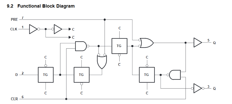

  • Thanks for the quick follow up Emrys.  Any suggestions on similar parts or ways to simulate this?  Or is the best solution to just "get it and try it"?
    I posted the functional block diagram below also.  Is the challenge in SPICE to get the TG (transmission gate, I think) blocks working properly?
  • The biggest trouble is making it work fast and accurately at all frequency ranges.
    I can build the above block diagram -- and, in fact, I have. If I do this with ideal gates, ie input = 1 or 0 and output = 1 or 0, then we run into problems with the transmission gates creating voltage spikes and values other than 1 or 0.
    I've tried working around this by adding thresholds to the inputs, but that makes the whole thing so slow that I can't realistically use it.
    The best solution I've found so far is to idealize the internal circuit so it stores a value without the master-slave latch configuration (which is how real DFFs are made). This does work very well and runs fast, but it won't work across all frequencies -- ie I can optimize it to work around ~1 kHz _or_ I can get it to work in the ~100 MHz range -- so far I haven't been able to get Tina-TI to correctly operate the device at both frequency ranges without modifying the simulation parameters.
