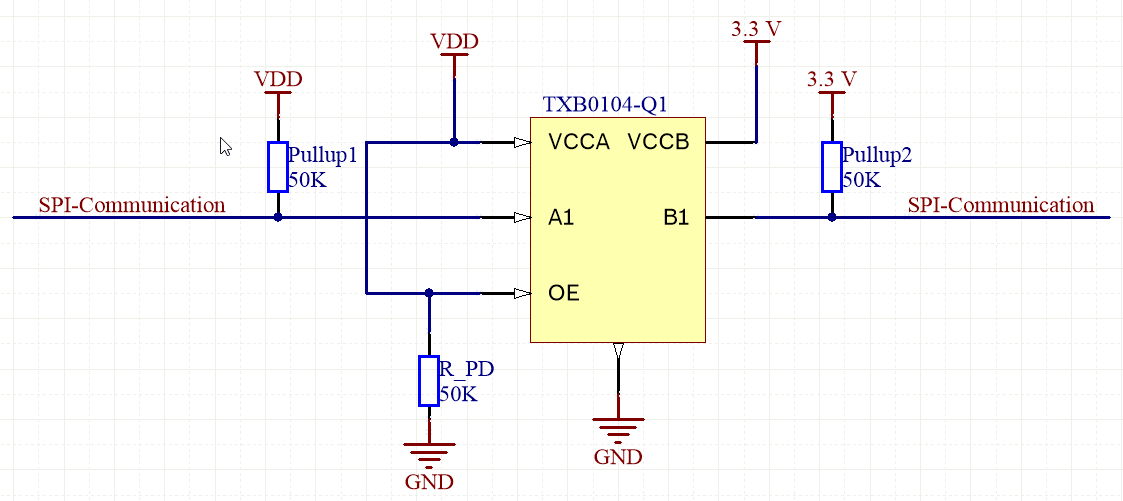

I am using the a level shifter. In my applecation OE-PIN should be tied to  VCCA (Low-level). Do I need to use a pulldown resistors between the VCCA and OE-PIN? if yeah should the R_PD value be minimum 50 Kohm or is the minimum value of the R_PD determined by the current-sourcing capability of the driver?
Thanks in Advance.
