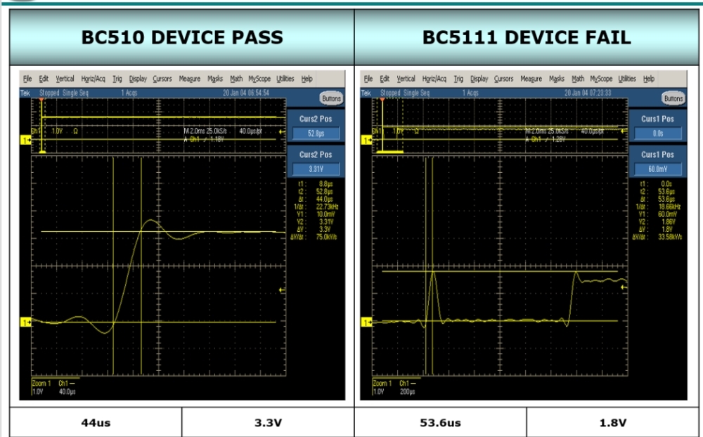

In order to Signal line is so long and capacitive load increases, B side output level is about 1.5V at one shot operation. (desired 3.3V)

    I attached waveform image.
    left is normal operation(3.3V), right is abnormal operation(1.5V).
    B side signal pcb trace length is about 400mm.
    My customer want to know that.
    1. According to the note "A Guide to Voltage Translation With TXB-Type Translators",
    even if mos TR is turned off, I think it will go up to 3.3V according to RC time.
    Please let me know some the reason to stay at 1.5V.
    2. And let me know how is the OS turn off operation.
    3. How can fix this? let me know solution? (add series resistor? add PU or PD resistor?)
    4. If TXB0108 is swapped TXS0108E, is this solution? (TXB0108 is push pull type.)

  • If the TXB is the only device driving the line, then the voltage should eventually reach 0 V or 3.3 V. So this looks as if some other device is affect the line; this could be another TXB pin, or some pull-up or pull-down resistor, or some other driver.
    Please show a schematic of everything that is connected to this line.
  • Hi Jake,
    For long traces and capacitive loads, TXB0108 may not be ideal device. You would probably have to consider using a strong buffered driver device like the SN74AXC8T245 which can support 1.5V to 3.3V operation.
    The OS circuit, as you have rightly mentioned in the post times out either around 10ns or 95% of Vcco whichever occurs first.
