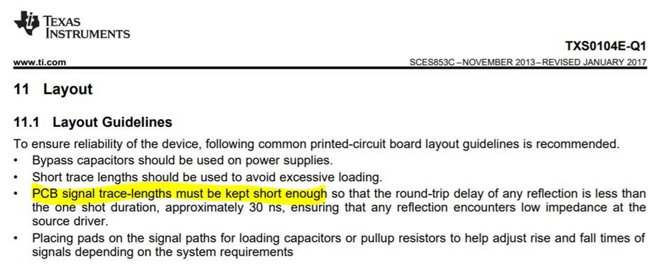

How do I know TXS0104-Q1 have larger capacitive load than TXB0104-Q1? Which chapter have description?
TXS0104-Q1 Layout guideline descript that the layout trace must keep short.
But we must connect the EMP device with long wire. Are there any problem?
Please kindly provide your suggestion.

  • Hi Kuan,
    What is the length of the wire, what is the cap loading? What is the datarate?
    Generally, the TXS0104e-q1 device doesn't have restriction on the capacitance listed in the datasheet as the TXB0104-Q1.
    The TXB datasheet lists up to 70pF cap loading, but TXS doesn't have the cap loading listed.
