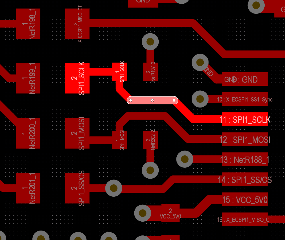

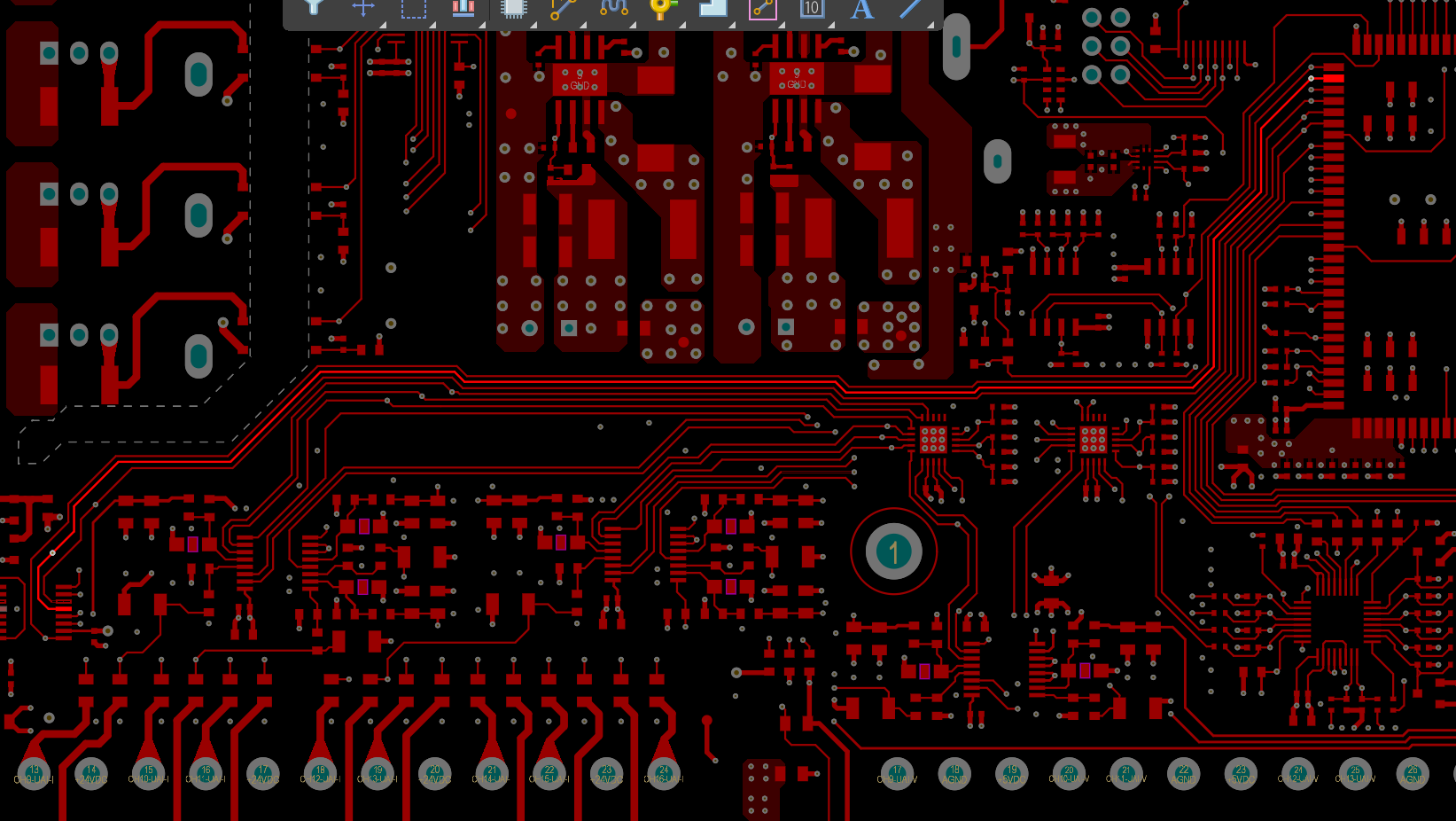

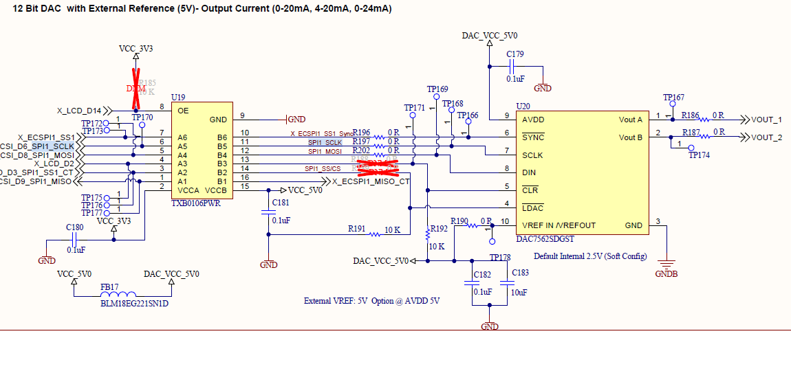

In our design we have used TXB0106 for SPI communication for 2 Chanel DAC from TI. When probed SCLK signal before and after voltage level translator found that the waveform is not level shifted to 5V also the waveform is very noise. We also isolated Removed R197 and checked the waveform there is no improvement. But DAC functionality wise works well.
could you please help below points to understand better
1. Why the SCLK output level not shifting to 5V logic
2. Why the waveform is noise ?
3
CH1 - Level Translator Output and CH2 - Level Translator Input
