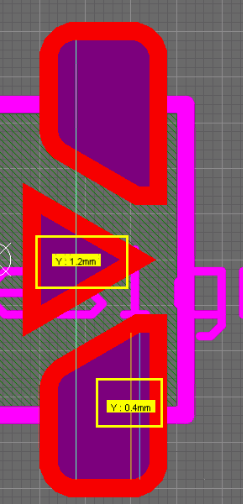

My customer would like to clarify the Footprint/Land Pattern for our SN74AXC1T45 (SN74AXC1T45DTQR). He exported the .bxl file to Allegro 16.6. He noticed that the pitch/distance between pin 6 and pin 4 is 0.8mm in the datasheet while in the footprint exported it is 0.9mm.
