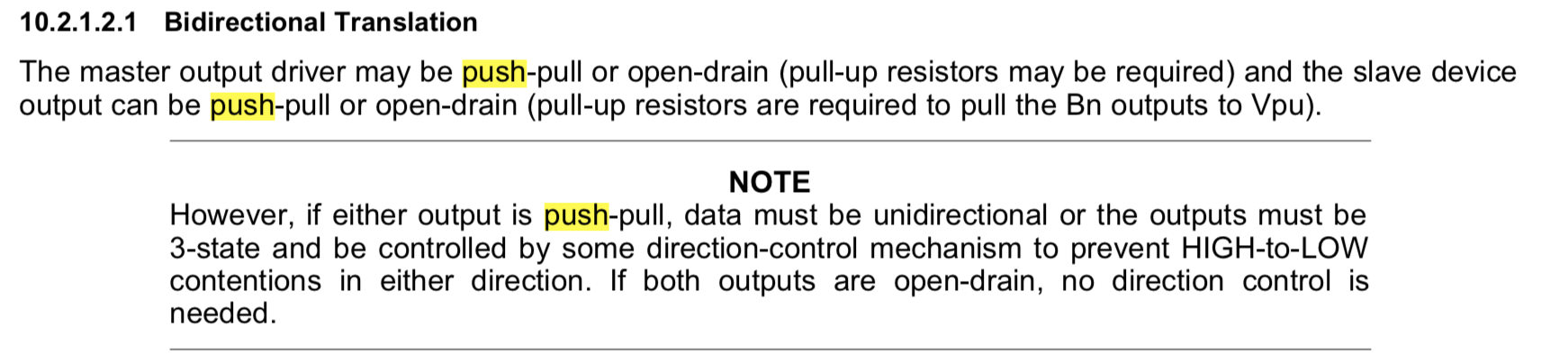

dear all,
in LSF0204 data sheet, I found below description. So, is it means that have to use open-drain mode for SPI application? thanks a lot.
dear all,
Hey Damien,
If its normal SPI, then the signals are unidirectional so it won't have to be open-drain.
